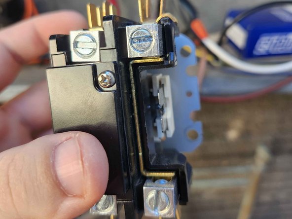

    • Identify the magnetic switch within the unit. It is typically located near the compressor or fan assembly.
    • Use a multimeter, or any voltage tester, to test for a voltage.
    • If you detect any voltage, revert back to step 1. If no voltage is detected in the magnetic switch, you can proceed to the next step.

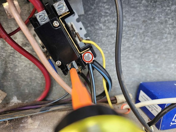

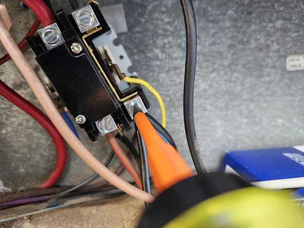

  5. Trane TT060C100A4 Electromagnetic Switch Replacement: crwdns2935265:05crwdnd2935265:01crwdnd2935265:03crwdne2935265:0 Trane TT060C100A4 Electromagnetic Switch Replacement: crwdns2935265:05crwdnd2935265:02crwdnd2935265:03crwdne2935265:0 Trane TT060C100A4 Electromagnetic Switch Replacement: crwdns2935265:05crwdnd2935265:03crwdnd2935265:03crwdne2935265:0
    • Use a 2.5 mm flathead screwdriver to loosen the 3 screws on the front face of the magnetic switch.
  6. Trane TT060C100A4 Electromagnetic Switch Replacement: crwdns2935265:06crwdnd2935265:01crwdnd2935265:03crwdne2935265:0 Trane TT060C100A4 Electromagnetic Switch Replacement: crwdns2935265:06crwdnd2935265:02crwdnd2935265:03crwdne2935265:0 Trane TT060C100A4 Electromagnetic Switch Replacement: crwdns2935265:06crwdnd2935265:03crwdnd2935265:03crwdne2935265:0
    • Use pliers to unplug the cables from the perimeter of the switch.
    • Take note of the socket for each cable to ensure proper placement during reassembly.

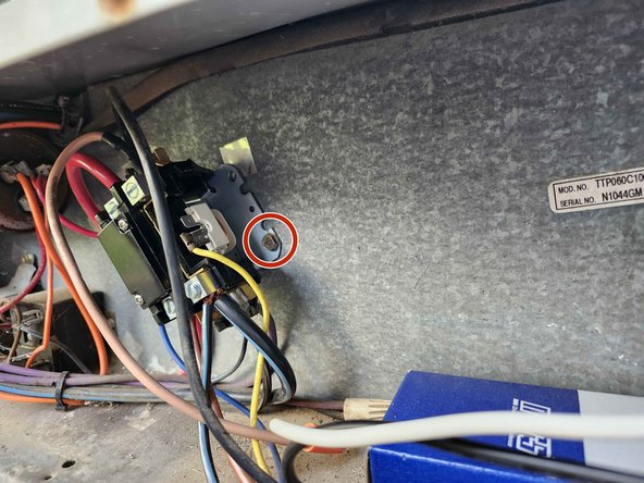

  7. Trane TT060C100A4 Electromagnetic Switch Replacement: crwdns2935265:07crwdnd2935265:01crwdnd2935265:03crwdne2935265:0 Trane TT060C100A4 Electromagnetic Switch Replacement: crwdns2935265:07crwdnd2935265:02crwdnd2935265:03crwdne2935265:0 Trane TT060C100A4 Electromagnetic Switch Replacement: crwdns2935265:07crwdnd2935265:03crwdnd2935265:03crwdne2935265:0
    • Use a #8 Hex socket bit and Impact driver or torque wrench to remove the two 12.7 mm bolts holding the switch to the AC.
    • Remove the old magnetic switch.
