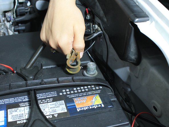

    • The battery is located on the driver's side of the engine compartment.
    • Loosen the 11mm nut on the collar holding the black wire to the negative terminal of the battery.
    • Lift up vertically on the wire and remove it from the battery contact pin.

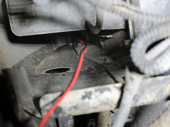

    • Get underneath the truck at this location.
    • Cut the red wire in the space between the fender and the bed using a wire cutter.

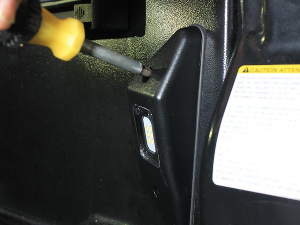

  6. Toyota Tacoma Bed Light Replacement: crwdns2935265:06crwdnd2935265:01crwdnd2935265:02crwdne2935265:0 Toyota Tacoma Bed Light Replacement: crwdns2935265:06crwdnd2935265:02crwdnd2935265:02crwdne2935265:0
    • Use a Phillips #2 screwdriver to remove the two screws holding the light enclosure to the bed.

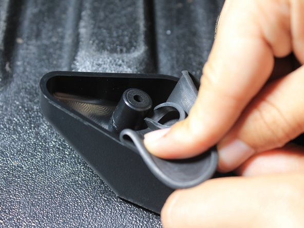

  7. Toyota Tacoma Bed Light Replacement: crwdns2935265:07crwdnd2935265:01crwdnd2935265:02crwdne2935265:0 Toyota Tacoma Bed Light Replacement: crwdns2935265:07crwdnd2935265:02crwdnd2935265:02crwdne2935265:0

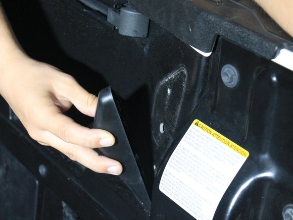

    • Remove the rubber backing on the light enclosure.
  8. Toyota Tacoma Bed Light Replacement: crwdns2935265:08crwdnd2935265:01crwdnd2935265:01crwdne2935265:0
    • Place the rubber backing on the new light enclosure.

  10. Toyota Tacoma Bed Light Replacement: crwdns2935265:010crwdnd2935265:01crwdnd2935265:02crwdne2935265:0 Toyota Tacoma Bed Light Replacement: crwdns2935265:010crwdnd2935265:02crwdnd2935265:02crwdne2935265:0
    • Put blue locktite on screws to keep them in place.
    • Screw new enclosure into place using a Phillips #2 screwdriver.

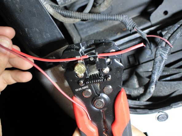

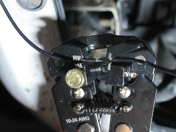

  11. Toyota Tacoma Bed Light Replacement: crwdns2935265:011crwdnd2935265:01crwdnd2935265:03crwdne2935265:0 Toyota Tacoma Bed Light Replacement: crwdns2935265:011crwdnd2935265:02crwdnd2935265:03crwdne2935265:0 Toyota Tacoma Bed Light Replacement: crwdns2935265:011crwdnd2935265:03crwdnd2935265:03crwdne2935265:0
    • Cut the new leads to the desired length underneath the truck.
    • Strip the wires using a wire stripper.

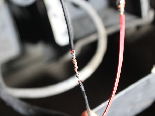

    • Wrap the exposed ends of the wires together, being sure to only connect alike colors.

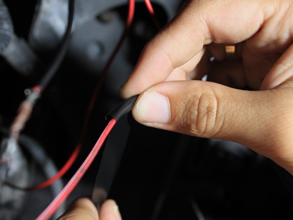

  14. Toyota Tacoma Bed Light Replacement: crwdns2935265:014crwdnd2935265:01crwdnd2935265:02crwdne2935265:0 Toyota Tacoma Bed Light Replacement: crwdns2935265:014crwdnd2935265:02crwdnd2935265:02crwdne2935265:0
    • Wrap the exposed wire in electrical tape to protect against the elements.

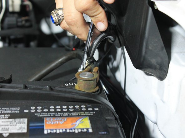

    • Reconnect the negative lead to the battery.
    • Tighten the collar using an 11mm wrench.

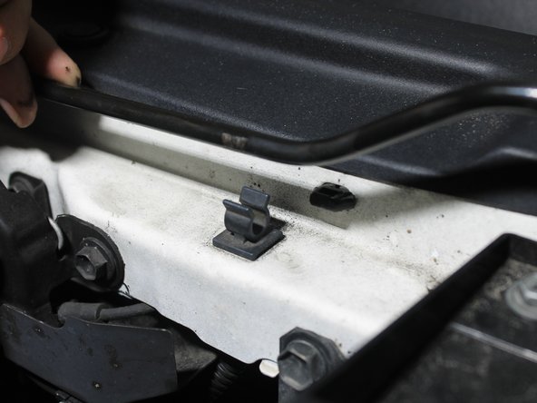

    • Close hood ensuring that the prop is placed in the designated clip.
