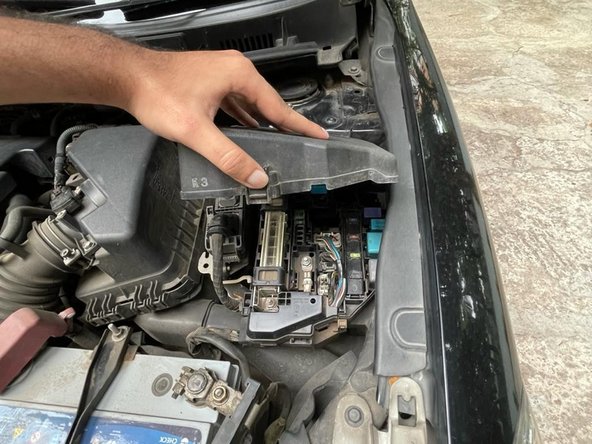

    • The fuse box is located on the right hand side, above the battery. It is denoted on the picture by the yellow square.

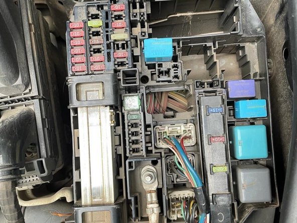

    • Gently push the tab in and lift the fuse box lid off.
    • Now, the fuse panel with various fuses of different amperage ratings and colours are shown.
    • Replacement should be done without water entering the fuse box in case of rain.

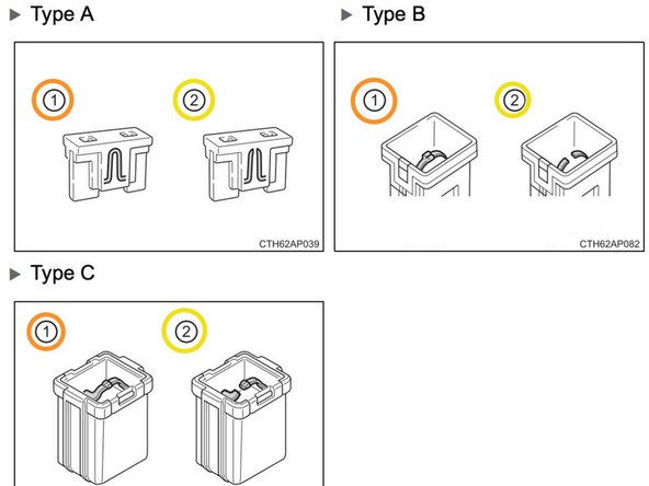

    • Check the fuse to determine whether the fuse is broken or not. If the internal wires inside the fuse is not attached, it must be changed. The picture shows three types of fuse:
    • Normal fuse
    • Broken fuse
    • The second picture showing three different types of fuse was extracted from Toyota's owners manual.

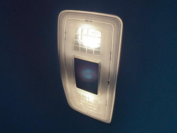

    • After you've replaced the fuse, start the car and check to see whether whatever the fuse was responsible for is now operational, such as your interior lighting.
