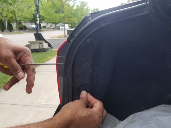

    • Open the trunk lid and remove the two black plastic fasteners on the side of the car with burnt out lights using a flat head screwdriver.

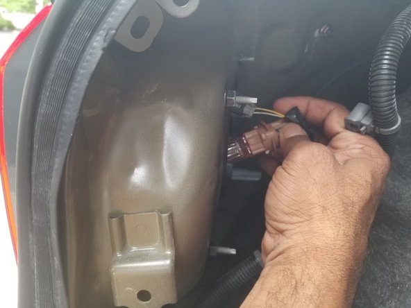

    • Pull back the carpet to access the bulbs and locate between the rear turn signal bulb and brake light.
    • The rear turn signal bulb is located at the top and has a grey cap.
    • The brake light is located at the bottom and has an orange cap.
  3. Toyota Corolla 2018 Brake Light Replacement: crwdns2935265:03crwdnd2935265:01crwdnd2935265:02crwdne2935265:0 Toyota Corolla 2018 Brake Light Replacement: crwdns2935265:03crwdnd2935265:02crwdnd2935265:02crwdne2935265:0
    • Turn the brake light counterclockwise and pull the old light straight out of the socket.
  4. Toyota Corolla 2018 Brake Light Replacement: crwdns2935265:04crwdnd2935265:01crwdnd2935265:01crwdne2935265:0
    • Replace the new bulb and push it in the socket.
  5. Toyota Corolla 2018 Brake Light Replacement: crwdns2935265:05crwdnd2935265:01crwdnd2935265:01crwdne2935265:0
    • Turn the socket clockwise while placing it in the housing.
