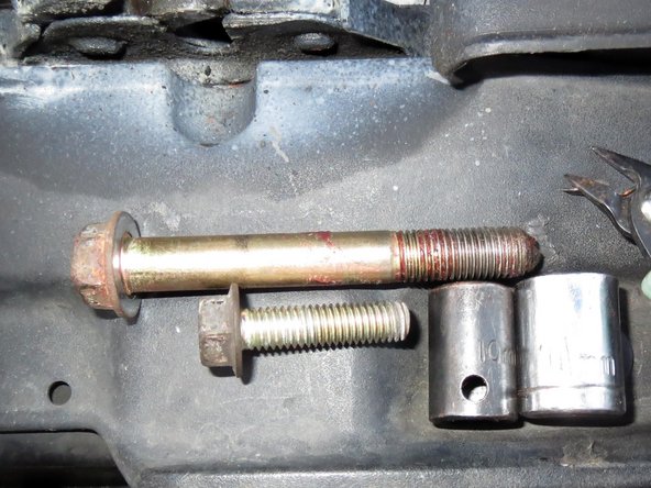

  5. Toyota Celica GT / GTS Alternator Troubleshooting and Replacement, Removing the alternator: crwdns2935265:05crwdnd2935265:01crwdnd2935265:03crwdne2935265:0 Toyota Celica GT / GTS Alternator Troubleshooting and Replacement, Removing the alternator: crwdns2935265:05crwdnd2935265:02crwdnd2935265:03crwdne2935265:0 Toyota Celica GT / GTS Alternator Troubleshooting and Replacement, Removing the alternator: crwdns2935265:05crwdnd2935265:03crwdnd2935265:03crwdne2935265:0
    • Unclip and remove the wire from a holding point on the side of the Alternator.
    • Unplug the 3 wire connector from the side of the alternator. If you did not B+ cable to perform the continuity test, disconnect it now with a 10mm socket.
    • Remove the 12mm bolt holding the top of the alternator in place, then remove the long 14mm bolt. You will need patience to racket it out as there is not a lot of room to move your wrench thanks to the A/C piping!

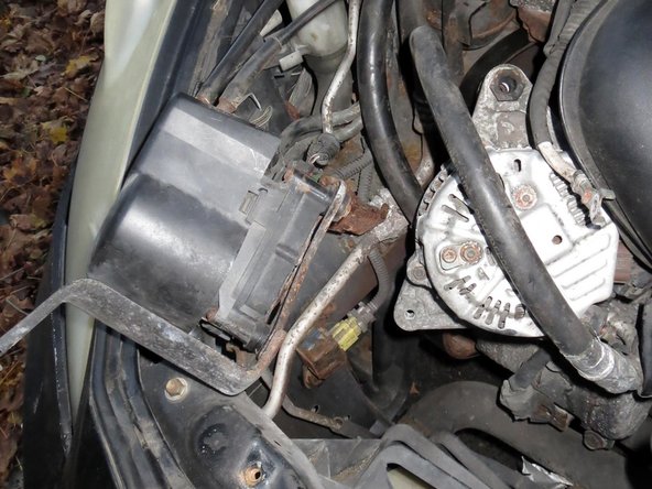

  6. Toyota Celica GT / GTS Alternator Troubleshooting and Replacement, Removing the alternator cont.: crwdns2935265:06crwdnd2935265:01crwdnd2935265:03crwdne2935265:0 Toyota Celica GT / GTS Alternator Troubleshooting and Replacement, Removing the alternator cont.: crwdns2935265:06crwdnd2935265:02crwdnd2935265:03crwdne2935265:0 Toyota Celica GT / GTS Alternator Troubleshooting and Replacement, Removing the alternator cont.: crwdns2935265:06crwdnd2935265:03crwdnd2935265:03crwdne2935265:0

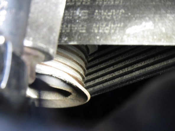

    • Using a 19mm socket and a long socket wrench, put the socket on the 19mm location on the side of the belt tensioner and push down to compress its piston and slacken the serpentine belt, while the serpentine belt has slack remove it from the alternator's pulley.
    • Optional: I unbolted the cruise control unit, removing three 10mm bolts to give me more room to pull out the old alternator. Also disconnecting the A/C cable will give you more room.

    • Important: Using a 19mm socket and a long wrench, compress the tensioner and place the Belt over the Alternators pully wheel. Release and check the belt is fully on all pully wheels, use a flashlight if necessary. Failing to do so can shred your belt. Check Service manual PDF 2, page 313 if you need more info regarding belt fitment.
