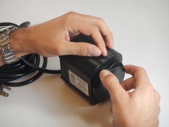

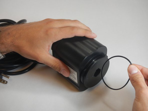

    4. TotalPond Pond Pump O-ring Replacement, O-Ring Removal: crwdns2935265:04crwdnd2935265:01crwdnd2935265:02crwdne2935265:0 TotalPond Pond Pump O-ring Replacement, O-Ring Removal: crwdns2935265:04crwdnd2935265:02crwdnd2935265:02crwdne2935265:0
      • While holding the pump with one hand, pinch the O-ring and slide it upward with your free hand so that a portion of the ring is lifted.
    5. TotalPond Pond Pump O-ring Replacement, O-Ring Removal continued: crwdns2935265:05crwdnd2935265:01crwdnd2935265:02crwdne2935265:0 TotalPond Pond Pump O-ring Replacement, O-Ring Removal continued: crwdns2935265:05crwdnd2935265:02crwdnd2935265:02crwdne2935265:0
      • With one finger from the hand that is holding the pump, push the lifted portion of the ring forward until it is completely detached from the pump.
