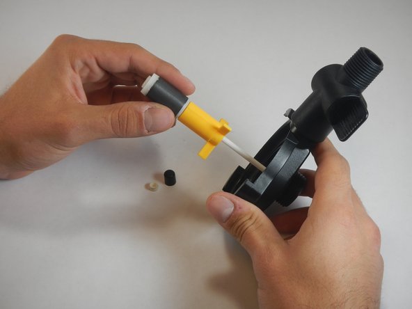

  3. TotalPond Pond Pump Impeller Spindle Replacement: crwdns2935265:03crwdnd2935265:01crwdnd2935265:02crwdne2935265:0 TotalPond Pond Pump Impeller Spindle Replacement: crwdns2935265:03crwdnd2935265:02crwdnd2935265:02crwdne2935265:0
    • Remove the rubber stop that is attached to the tube that runs through the middle of the impeller. Also remove the bearing that is between the stop and the impeller.

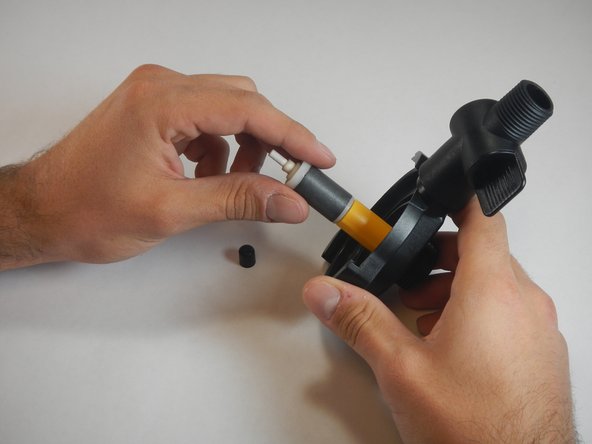

  4. TotalPond Pond Pump Impeller Spindle Replacement: crwdns2935265:04crwdnd2935265:01crwdnd2935265:02crwdne2935265:0 TotalPond Pond Pump Impeller Spindle Replacement: crwdns2935265:04crwdnd2935265:02crwdnd2935265:02crwdne2935265:0
    • Hold the impeller cover with one hand and the impeller with the other. Slide the impeller out.

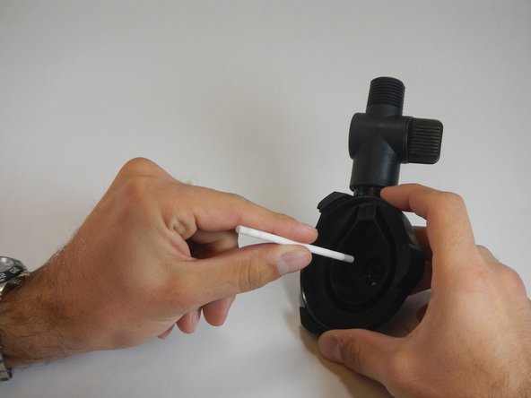

  5. TotalPond Pond Pump Impeller Spindle Replacement: crwdns2935265:05crwdnd2935265:01crwdnd2935265:02crwdne2935265:0 TotalPond Pond Pump Impeller Spindle Replacement: crwdns2935265:05crwdnd2935265:02crwdnd2935265:02crwdne2935265:0
    • Hold the impeller spindle and wiggle it side to side until it detaches from the impeller cover.
