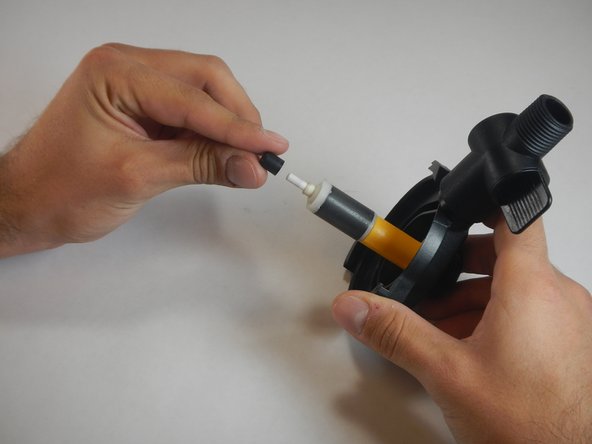

TotalPond Pond Pump Impeller Rubber Stop Replacement
  1. TotalPond Pond Pump Impeller Rubber Stop Replacement, Impeller Rubber Stop: crwdns2935265:01crwdnd2935265:01crwdnd2935265:03crwdne2935265:0 TotalPond Pond Pump Impeller Rubber Stop Replacement, Impeller Rubber Stop: crwdns2935265:01crwdnd2935265:02crwdnd2935265:03crwdne2935265:0 TotalPond Pond Pump Impeller Rubber Stop Replacement, Impeller Rubber Stop: crwdns2935265:01crwdnd2935265:03crwdnd2935265:03crwdne2935265:0
    • Hold the inlet screen and rotate it counterclockwise to unscrew it. It is helpful to remove the inlet screen so that it is not damaged during the replacement process.
  2. TotalPond Pond Pump Impeller Rubber Stop Replacement: crwdns2935265:02crwdnd2935265:01crwdnd2935265:03crwdne2935265:0 TotalPond Pond Pump Impeller Rubber Stop Replacement: crwdns2935265:02crwdnd2935265:02crwdnd2935265:03crwdne2935265:0 TotalPond Pond Pump Impeller Rubber Stop Replacement: crwdns2935265:02crwdnd2935265:03crwdnd2935265:03crwdne2935265:0
    • Firmly hold the pump block with one hand and the impeller housing with the other hand. Rotate impeller housing counterclockwise until it is released.
  3. TotalPond Pond Pump Impeller Rubber Stop Replacement: crwdns2935265:03crwdnd2935265:01crwdnd2935265:02crwdne2935265:0 TotalPond Pond Pump Impeller Rubber Stop Replacement: crwdns2935265:03crwdnd2935265:02crwdnd2935265:02crwdne2935265:0
    • Remove the rubber stop that is attached to the tube that runs through the middle of the impeller.
