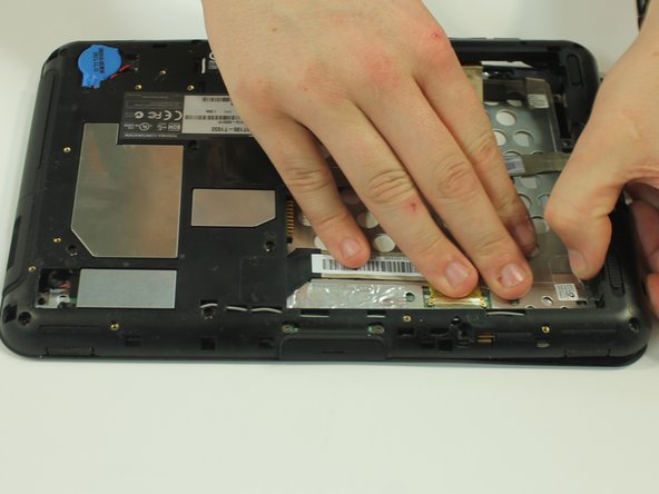

  5. Toshiba Thrive Speakers Replacement, Speakers: crwdns2935265:05crwdnd2935265:01crwdnd2935265:02crwdne2935265:0 Toshiba Thrive Speakers Replacement, Speakers: crwdns2935265:05crwdnd2935265:02crwdnd2935265:02crwdne2935265:0

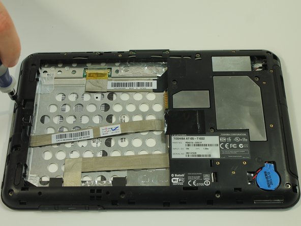

    • Start by using a PH0 phillips head screwdriver to remove the 12 screws holding on the back cover
    • All of these screws are identical so don't worry about getting them mixed up.

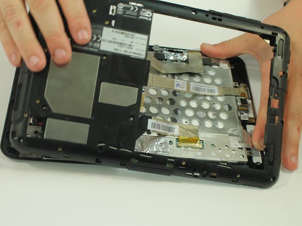

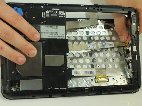

  6. Toshiba Thrive Speakers Replacement: crwdns2935265:06crwdnd2935265:01crwdnd2935265:03crwdne2935265:0 Toshiba Thrive Speakers Replacement: crwdns2935265:06crwdnd2935265:02crwdnd2935265:03crwdne2935265:0 Toshiba Thrive Speakers Replacement: crwdns2935265:06crwdnd2935265:03crwdnd2935265:03crwdne2935265:0
    • Start to gently pry the back of the device off, while leaving it loosely in place.
    • Be careful not to tear or damage the cables when removing the back.

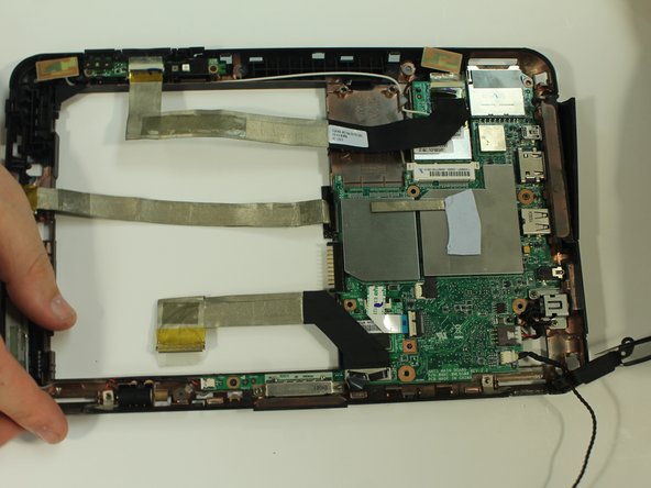

  7. Toshiba Thrive Speakers Replacement: crwdns2935265:07crwdnd2935265:01crwdnd2935265:03crwdne2935265:0 Toshiba Thrive Speakers Replacement: crwdns2935265:07crwdnd2935265:02crwdnd2935265:03crwdne2935265:0 Toshiba Thrive Speakers Replacement: crwdns2935265:07crwdnd2935265:03crwdnd2935265:03crwdne2935265:0
    • Once the back of the case is off, disconnect the wires by gently pulling on the plastic tabs as shown.

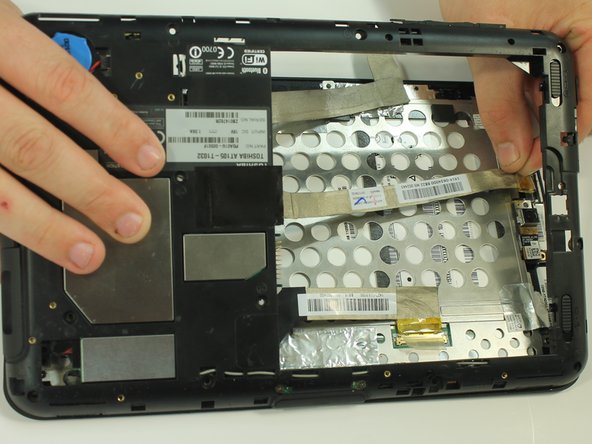

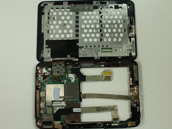

  8. Toshiba Thrive Speakers Replacement: crwdns2935265:08crwdnd2935265:01crwdnd2935265:02crwdne2935265:0 Toshiba Thrive Speakers Replacement: crwdns2935265:08crwdnd2935265:02crwdnd2935265:02crwdne2935265:0
    • carefully open the device like a book and lay the two halves beside each other.
    • put the screen assembly in a safe place as you complete the rest of the guide.

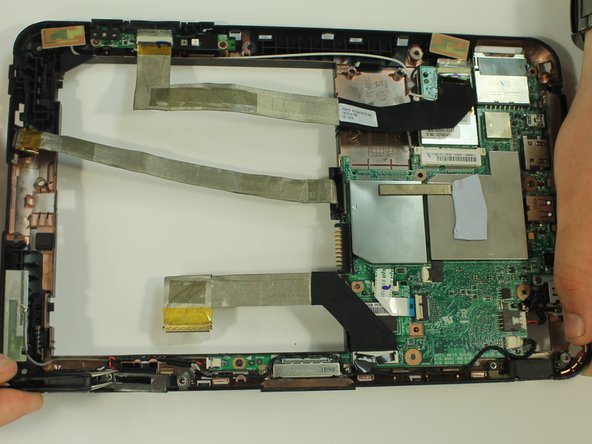

  9. Toshiba Thrive Speakers Replacement: crwdns2935265:09crwdnd2935265:01crwdnd2935265:02crwdne2935265:0 Toshiba Thrive Speakers Replacement: crwdns2935265:09crwdnd2935265:02crwdnd2935265:02crwdne2935265:0

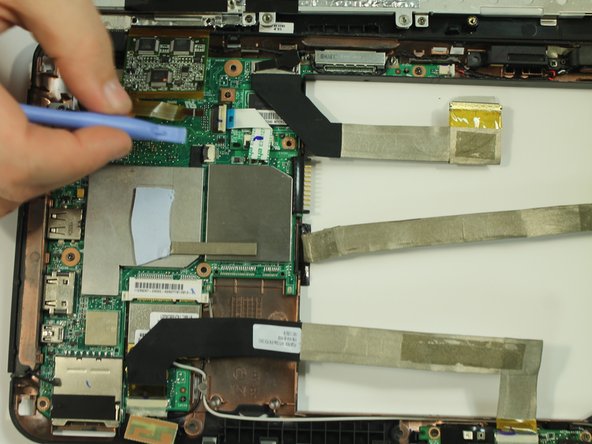

    • Use the plastic opening tool to open the latch holding the last wire to the back of the device.
  10. Toshiba Thrive Speakers Replacement: crwdns2935265:010crwdnd2935265:01crwdnd2935265:03crwdne2935265:0 Toshiba Thrive Speakers Replacement: crwdns2935265:010crwdnd2935265:02crwdnd2935265:03crwdne2935265:0 Toshiba Thrive Speakers Replacement: crwdns2935265:010crwdnd2935265:03crwdnd2935265:03crwdne2935265:0

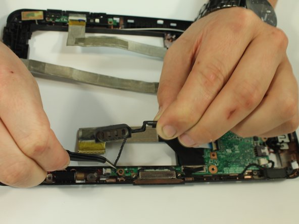

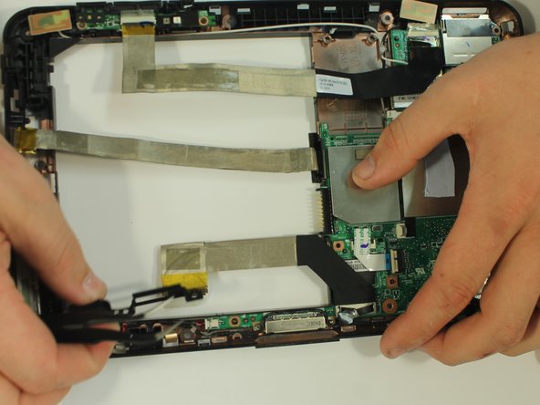

    • Remove the two screws holding the speakers in place. The screws are 3mm in length and require a PH0 screwdriver.
    • Using a pair of tweezers, remove the speaker.
  11. Toshiba Thrive Speakers Replacement: crwdns2935265:011crwdnd2935265:01crwdnd2935265:03crwdne2935265:0 Toshiba Thrive Speakers Replacement: crwdns2935265:011crwdnd2935265:02crwdnd2935265:03crwdne2935265:0 Toshiba Thrive Speakers Replacement: crwdns2935265:011crwdnd2935265:03crwdnd2935265:03crwdne2935265:0

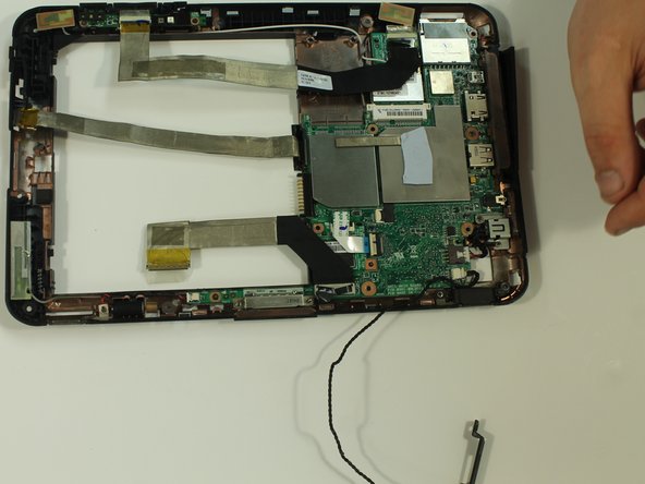

    • Use the tweezers to help you remove the speaker wire from the clips holding them in place.
    • After removal place the left speaker on the side.
  12. Toshiba Thrive Speakers Replacement: crwdns2935265:012crwdnd2935265:01crwdnd2935265:03crwdne2935265:0 Toshiba Thrive Speakers Replacement: crwdns2935265:012crwdnd2935265:02crwdnd2935265:03crwdne2935265:0 Toshiba Thrive Speakers Replacement: crwdns2935265:012crwdnd2935265:03crwdnd2935265:03crwdne2935265:0

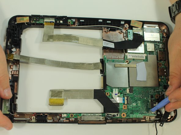

    • Use the tweezers again to help you remove the right speaker from its position.
    • Use a plastic opening tool to pull the connector connecting the speaker to the motherboard out of its port.
