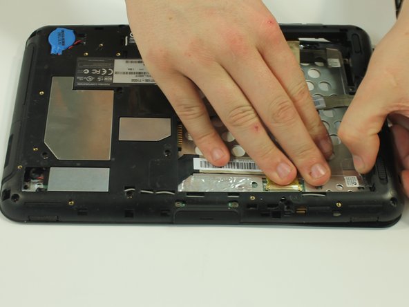

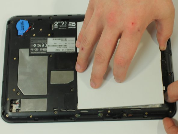

      • Remove back cover by prying away from the Thrive.
      • The easiest place to pry from is one of the two speakers.

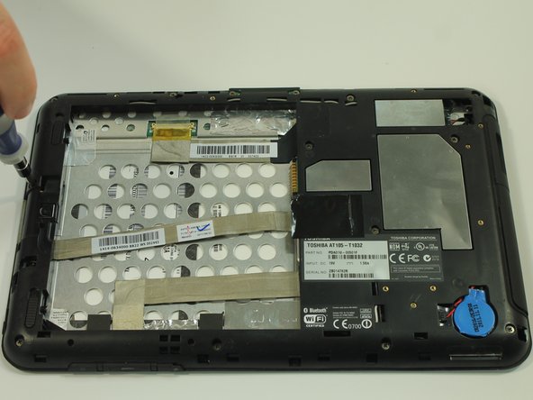

    1. Toshiba Thrive Front Camera Replacement, Midframe: crwdns2935265:05crwdnd2935265:01crwdnd2935265:02crwdne2935265:0 Toshiba Thrive Front Camera Replacement, Midframe: crwdns2935265:05crwdnd2935265:02crwdnd2935265:02crwdne2935265:0

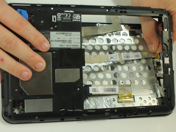

      • Start by using a screwdriver to remove the 12 screws holding on the back cover. The screws are 5mm in length and require a PH0 screwdriver.
      • All of these screws are identical so don't worry about getting them mixed up.
    2. Toshiba Thrive Front Camera Replacement: crwdns2935265:06crwdnd2935265:01crwdnd2935265:03crwdne2935265:0 Toshiba Thrive Front Camera Replacement: crwdns2935265:06crwdnd2935265:02crwdnd2935265:03crwdne2935265:0 Toshiba Thrive Front Camera Replacement: crwdns2935265:06crwdnd2935265:03crwdnd2935265:03crwdne2935265:0
      • Start to gently pry the back of the device off, while leaving it loosely in place.
      • Be careful not to tear or damage the cables when removing the back.
    3. Toshiba Thrive Front Camera Replacement: crwdns2935265:07crwdnd2935265:01crwdnd2935265:03crwdne2935265:0 Toshiba Thrive Front Camera Replacement: crwdns2935265:07crwdnd2935265:02crwdnd2935265:03crwdne2935265:0 Toshiba Thrive Front Camera Replacement: crwdns2935265:07crwdnd2935265:03crwdnd2935265:03crwdne2935265:0

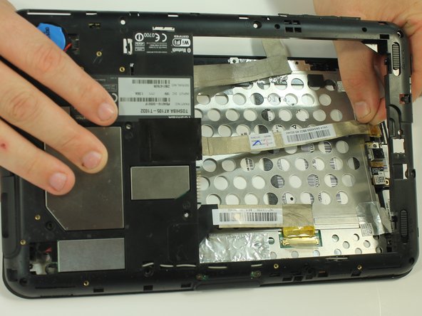

      • Once the back of the case is off, disconnect the wires by gently pulling on the plastic tabs as shown.

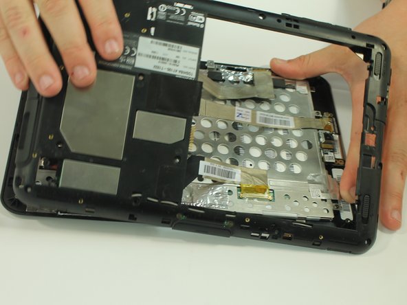

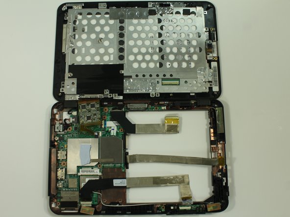

    4. Toshiba Thrive Front Camera Replacement: crwdns2935265:08crwdnd2935265:01crwdnd2935265:02crwdne2935265:0 Toshiba Thrive Front Camera Replacement: crwdns2935265:08crwdnd2935265:02crwdnd2935265:02crwdne2935265:0
      • Carefully open the device like a book and lay the two halves beside each other.
    1. Toshiba Thrive Front Camera Replacement, Front Camera: crwdns2935265:09crwdnd2935265:01crwdnd2935265:02crwdne2935265:0 Toshiba Thrive Front Camera Replacement, Front Camera: crwdns2935265:09crwdnd2935265:02crwdnd2935265:02crwdne2935265:0

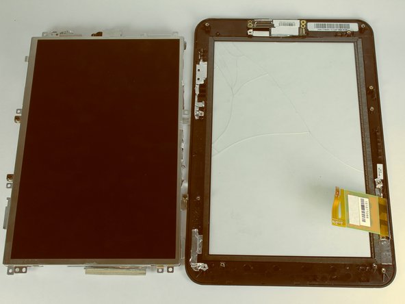

      • Separate the two halves of your Thrive
      • Using a Phillips screwdriver, remove the six screws holding the LCD in place. These screws are 3mm in length and require a PH0 screwdriver.
    2. Toshiba Thrive Front Camera Replacement: crwdns2935265:010crwdnd2935265:01crwdnd2935265:01crwdne2935265:0
      • With a spudger, disconnect the cable connecting the camera to the motherboard.
    3. Toshiba Thrive Front Camera Replacement: crwdns2935265:011crwdnd2935265:01crwdnd2935265:02crwdne2935265:0 Toshiba Thrive Front Camera Replacement: crwdns2935265:011crwdnd2935265:02crwdnd2935265:02crwdne2935265:0
      • Lift up the LCD from the screen and place it on the side

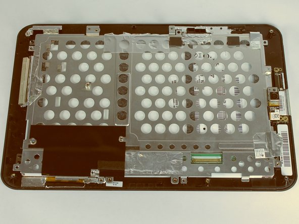

    4. Toshiba Thrive Front Camera Replacement: crwdns2935265:012crwdnd2935265:01crwdnd2935265:02crwdne2935265:0 Toshiba Thrive Front Camera Replacement: crwdns2935265:012crwdnd2935265:02crwdnd2935265:02crwdne2935265:0
      • Remove the one screw holding the camera in place. The screw is 3mm in length and requires a PH0 screwdriver.
      • Lift up the camera from the screen.
