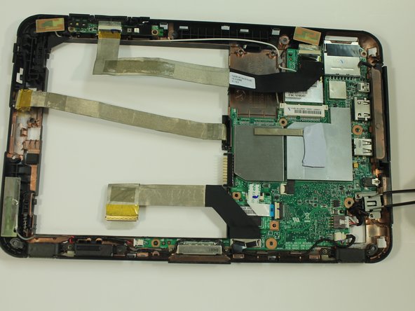

  5. Toshiba Thrive Charging Port Replacement, Midframe: crwdns2935265:05crwdnd2935265:01crwdnd2935265:02crwdne2935265:0 Toshiba Thrive Charging Port Replacement, Midframe: crwdns2935265:05crwdnd2935265:02crwdnd2935265:02crwdne2935265:0
    • Start by using a screwdriver to remove the 12 screws holding on the back cover. The screws are 5mm in length and require a PH0 screwdriver.
    • All of these screws are identical so don't worry about getting them mixed up.

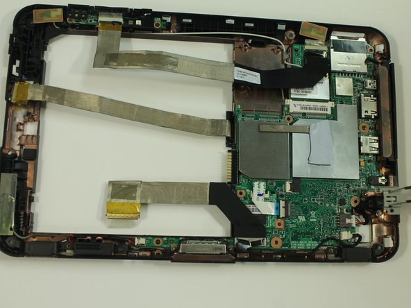

  8. Toshiba Thrive Charging Port Replacement: crwdns2935265:08crwdnd2935265:01crwdnd2935265:02crwdne2935265:0 Toshiba Thrive Charging Port Replacement: crwdns2935265:08crwdnd2935265:02crwdnd2935265:02crwdne2935265:0
    • Carefully open the device like a book and lay the two halves beside each other.

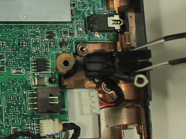

  9. Toshiba Thrive Charging Port Replacement, Charging Port: crwdns2935265:09crwdnd2935265:01crwdnd2935265:03crwdne2935265:0 Toshiba Thrive Charging Port Replacement, Charging Port: crwdns2935265:09crwdnd2935265:02crwdnd2935265:03crwdne2935265:0 Toshiba Thrive Charging Port Replacement, Charging Port: crwdns2935265:09crwdnd2935265:03crwdnd2935265:03crwdne2935265:0
    • Remove the two screws holding the charging port in place. The screws are 3mm in length and require a PH0 screwdriver.
    • Using a pair of tweezers, lift up the charging port's protective covering

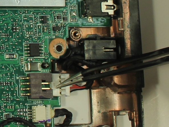

  10. Toshiba Thrive Charging Port Replacement: crwdns2935265:010crwdnd2935265:01crwdnd2935265:03crwdne2935265:0 Toshiba Thrive Charging Port Replacement: crwdns2935265:010crwdnd2935265:02crwdnd2935265:03crwdne2935265:0 Toshiba Thrive Charging Port Replacement: crwdns2935265:010crwdnd2935265:03crwdnd2935265:03crwdne2935265:0
    • Use the tweezers to pull out the connector connecting the charging port to the motherboard.
    • Using the tweezers again, gently lift up the charging port from your Thrive.

I added "better pictures" flag because i was having trouble following the last step cause i couldnt see anything.
