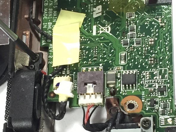

  8. Toshiba Thrive 4G Speaker Replacement, Locate the speakers: crwdns2935265:08crwdnd2935265:01crwdnd2935265:01crwdne2935265:0
    • The speakers are located on the right side of the device. There is one speaker towards the top of the device and one on the bottom, just below the volume control buttons.
  9. Toshiba Thrive 4G Speaker Replacement, Detach Cord: crwdns2935265:09crwdnd2935265:01crwdnd2935265:02crwdne2935265:0 Toshiba Thrive 4G Speaker Replacement, Detach Cord: crwdns2935265:09crwdnd2935265:02crwdnd2935265:02crwdne2935265:0
    • Once locating the speaker, detach the wire that is connected to the logic board.
    • Use the pry tool to pull the cord away from the logic board.

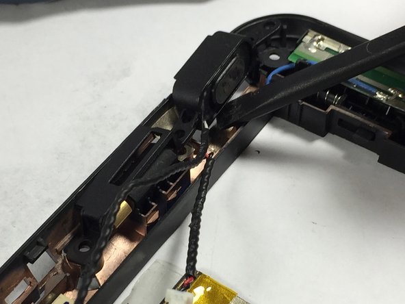

  10. Toshiba Thrive 4G Speaker Replacement, Remove Top Speaker: crwdns2935265:010crwdnd2935265:01crwdnd2935265:02crwdne2935265:0 Toshiba Thrive 4G Speaker Replacement, Remove Top Speaker: crwdns2935265:010crwdnd2935265:02crwdnd2935265:02crwdne2935265:0
    • Locate the screw holding the speaker in place. It will be located at the bottom edge of the speaker.
    • Use the phillips #0 screwdriver to remove the screw
    • Use the pry tool to remove the speaker from the board.

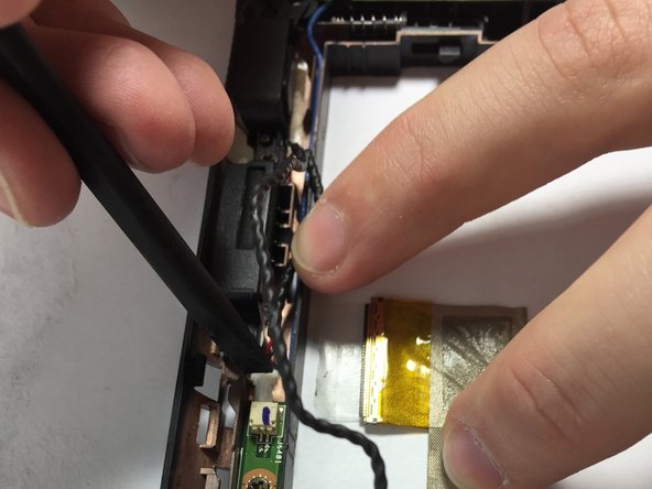

  11. Toshiba Thrive 4G Speaker Replacement, Remove the Wiring: crwdns2935265:011crwdnd2935265:01crwdnd2935265:01crwdne2935265:0
    • The top speaker is connected to the bottom speaker through a black wire.
    • Pull the wire out of place with your fingers, until you reach the second speaker which is just below where the volume control buttons are located.

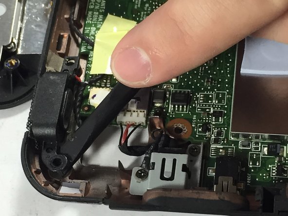

  12. Toshiba Thrive 4G Speaker Replacement, Remove Second Speaker: crwdns2935265:012crwdnd2935265:01crwdnd2935265:03crwdne2935265:0 Toshiba Thrive 4G Speaker Replacement, Remove Second Speaker: crwdns2935265:012crwdnd2935265:02crwdnd2935265:03crwdne2935265:0 Toshiba Thrive 4G Speaker Replacement, Remove Second Speaker: crwdns2935265:012crwdnd2935265:03crwdnd2935265:03crwdne2935265:0
    • Removing the second speaker is the same as removing the first speaker.
    • Locate the screw and unscrew the speaker, using the phillips #0 screwdriver.
    • Use the pry tool to remove the speaker from it's place
