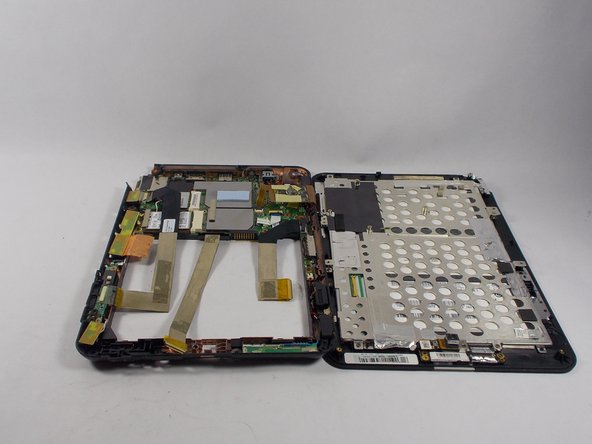

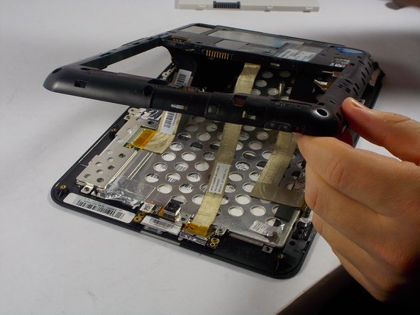

  5. Toshiba Thrive 4G Front Facing Camera Replacement, Remove Inner Casing: crwdns2935265:05crwdnd2935265:01crwdnd2935265:03crwdne2935265:0 Toshiba Thrive 4G Front Facing Camera Replacement, Remove Inner Casing: crwdns2935265:05crwdnd2935265:02crwdnd2935265:03crwdne2935265:0 Toshiba Thrive 4G Front Facing Camera Replacement, Remove Inner Casing: crwdns2935265:05crwdnd2935265:03crwdnd2935265:03crwdne2935265:0
    • Follow the steps outlined in the battery replacement guide to remove the outer casing, and the battery from their position
    • Locate and remove the 14 screws that are located along the outer edge of the tablet. To do this use the a phillips #0 screwdriver.
    • Use the pry tool to loosen the bond between the inner casing and the metal shell below the plastic casing. To do this place the pry tool between the two surfaces and push up.
    • Repeat the last step on each side of the tablet
    • When the plastic casing becomes loose enough you can pull it off using your hands

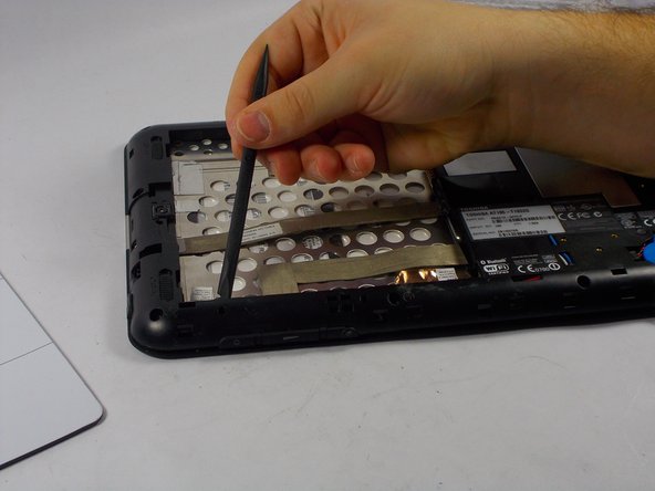

  6. Toshiba Thrive 4G Front Facing Camera Replacement, Detach Ribbons: crwdns2935265:06crwdnd2935265:01crwdnd2935265:02crwdne2935265:0 Toshiba Thrive 4G Front Facing Camera Replacement, Detach Ribbons: crwdns2935265:06crwdnd2935265:02crwdnd2935265:02crwdne2935265:0
    • When lifting the plastic casing up you will notice multiple ribbons attached to the metal shell.
    • Use the pry tool to gently lift up the tape holding the ribbons down
    • You can now safely lift the rest of the plastic shell up off of the device

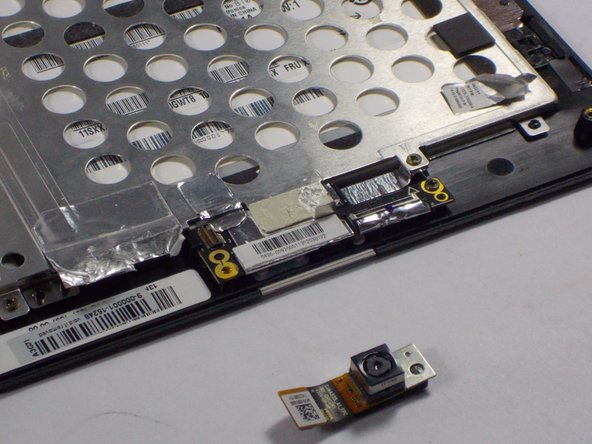

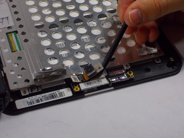

  7. Toshiba Thrive 4G Front Facing Camera Replacement, Remove the Camera: crwdns2935265:07crwdnd2935265:01crwdnd2935265:03crwdne2935265:0 Toshiba Thrive 4G Front Facing Camera Replacement, Remove the Camera: crwdns2935265:07crwdnd2935265:02crwdnd2935265:03crwdne2935265:0 Toshiba Thrive 4G Front Facing Camera Replacement, Remove the Camera: crwdns2935265:07crwdnd2935265:03crwdnd2935265:03crwdne2935265:0
    • To remove the camera you must first remove one screw that is holding it in place. You will need the phillips #0 screwdriver to complete this step
    • Next you must detach the ribbon connected to the camera. To do this use the pry tool to gently lift the tape out of place
    • Next use the pry tool to lift the rest of the camera off of the platform
