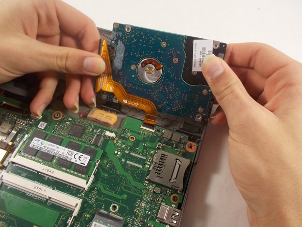

  8. Toshiba Tecra Z50-A Hard Drive Replacement, Hard Drive: crwdns2935265:08crwdnd2935265:01crwdnd2935265:01crwdne2935265:0
    • Lift up on the hard drive.
  9. Toshiba Tecra Z50-A Hard Drive Replacement: crwdns2935265:09crwdnd2935265:01crwdnd2935265:02crwdne2935265:0 Toshiba Tecra Z50-A Hard Drive Replacement: crwdns2935265:09crwdnd2935265:02crwdnd2935265:02crwdne2935265:0
    • Pull out the plug from the hard drive.
