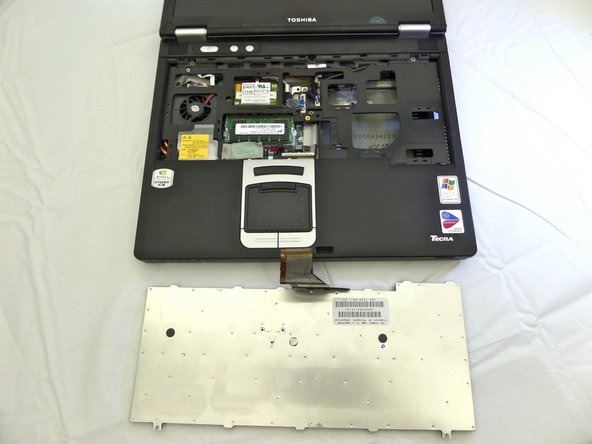

    • Pop the keyboard up gently and rest on top of the touch pad
    • The keyboard is attached underneath by a thin film. Do not rip the keyboard off. Gently lay it down without ripping the film.
  8. Toshiba Tecra M2 CPU Replacement: crwdns2935265:08crwdnd2935265:01crwdnd2935265:02crwdne2935265:0 Toshiba Tecra M2 CPU Replacement: crwdns2935265:08crwdnd2935265:02crwdnd2935265:02crwdne2935265:0
    • Using a #00 phillips head screwdriver, remove the 6mm screw holding the metal plate down.
  9. Toshiba Tecra M2 CPU Replacement: crwdns2935265:09crwdnd2935265:01crwdnd2935265:02crwdne2935265:0 Toshiba Tecra M2 CPU Replacement: crwdns2935265:09crwdnd2935265:02crwdnd2935265:02crwdne2935265:0
    • Gently remove the keyboard connector film from the motherboard with fingers by lifting upwards.
    • Set aside the keyboard.
