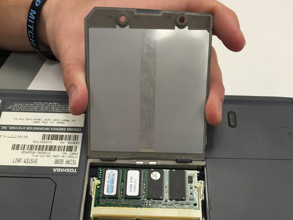

    • Position device so the screen is face down.
    • Locate RAM Panel.
  4. Toshiba Tecra 8200 RAM Replacement: crwdns2935265:04crwdnd2935265:01crwdnd2935265:02crwdne2935265:0 Toshiba Tecra 8200 RAM Replacement: crwdns2935265:04crwdnd2935265:02crwdnd2935265:02crwdne2935265:0
    • Remove two Phillips #00 screws labeled F4.
    • Remove panel.

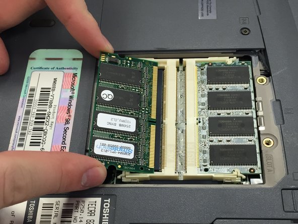

  5. Toshiba Tecra 8200 RAM Replacement: crwdns2935265:05crwdnd2935265:01crwdnd2935265:02crwdne2935265:0 Toshiba Tecra 8200 RAM Replacement: crwdns2935265:05crwdnd2935265:02crwdnd2935265:02crwdne2935265:0
    • Pinch clips on each side of RAM chips to release.
    • Gently remove RAM chips at a 45 degree angle. Use a plastic opening tool if RAM chips do not pop open.
