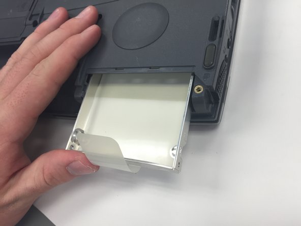

  4. Toshiba Tecra 8200 Hard Drive Replacement: crwdns2935265:04crwdnd2935265:01crwdnd2935265:02crwdne2935265:0 Toshiba Tecra 8200 Hard Drive Replacement: crwdns2935265:04crwdnd2935265:02crwdnd2935265:02crwdne2935265:0
    • Pull the tab to remove the hard drive.
    • Insert the new hard drive by pushing it into the compartment, leaving the new "pull" tab exposed.
  5. Toshiba Tecra 8200 Hard Drive Replacement: crwdns2935265:05crwdnd2935265:01crwdnd2935265:02crwdne2935265:0 Toshiba Tecra 8200 Hard Drive Replacement: crwdns2935265:05crwdnd2935265:02crwdnd2935265:02crwdne2935265:0
    • Tuck the "pull" tab back into the hard drive compartment.
    • Replace the panel.
    • Replace the single F4 screw.
