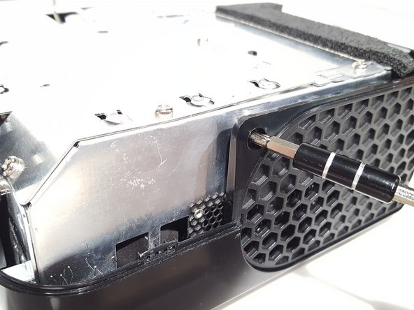

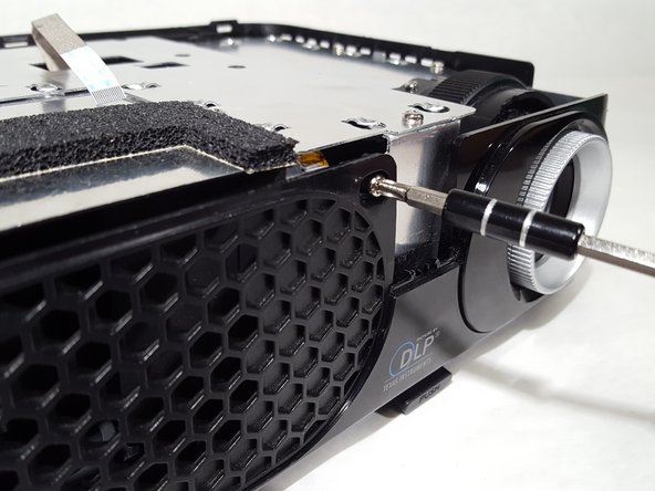

    • Start by removing the two screws on the bottom of the device as shown.

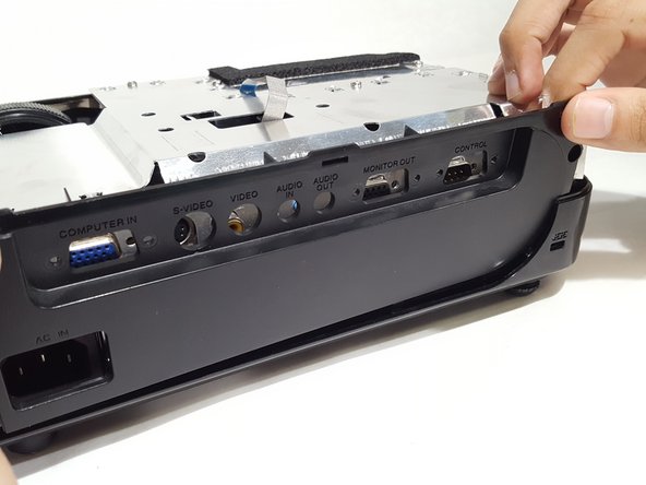

    • Remove the top plastic cover from the device. The back is snapped on so it would help to have leverage from a prying tool.
    • Remove the ribbon cable attached to the plastic piece just removed. Remember its orientation for re-assembling later.

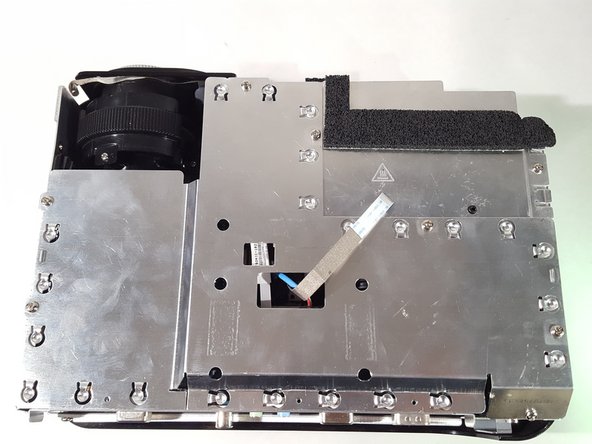

  3. Toshiba TDP-XP2 Fuse Replacement: crwdns2935265:03crwdnd2935265:01crwdnd2935265:03crwdne2935265:0 Toshiba TDP-XP2 Fuse Replacement: crwdns2935265:03crwdnd2935265:02crwdnd2935265:03crwdne2935265:0 Toshiba TDP-XP2 Fuse Replacement: crwdns2935265:03crwdnd2935265:03crwdnd2935265:03crwdne2935265:0

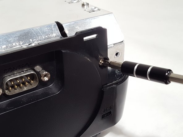

    • Remove the screws from the case located around the device.
  4. Toshiba TDP-XP2 Fuse Replacement: crwdns2935265:04crwdnd2935265:01crwdnd2935265:01crwdne2935265:0
    • Remove the plastic panels from the body.
  5. Toshiba TDP-XP2 Fuse Replacement: crwdns2935265:05crwdnd2935265:01crwdnd2935265:03crwdne2935265:0 Toshiba TDP-XP2 Fuse Replacement: crwdns2935265:05crwdnd2935265:02crwdnd2935265:03crwdne2935265:0 Toshiba TDP-XP2 Fuse Replacement: crwdns2935265:05crwdnd2935265:03crwdnd2935265:03crwdne2935265:0

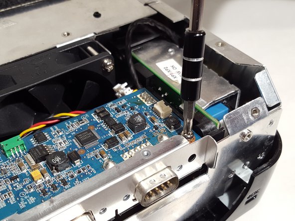

    • Remove the screws from the IO panel.
    • Pull up on the panel and remove it.
  6. Toshiba TDP-XP2 Fuse Replacement: crwdns2935265:06crwdnd2935265:01crwdnd2935265:02crwdne2935265:0 Toshiba TDP-XP2 Fuse Replacement: crwdns2935265:06crwdnd2935265:02crwdnd2935265:02crwdne2935265:0
    • Unscrew the screws from the metal shielding to remove it.
  7. Toshiba TDP-XP2 Fuse Replacement: crwdns2935265:07crwdnd2935265:01crwdnd2935265:03crwdne2935265:0 Toshiba TDP-XP2 Fuse Replacement: crwdns2935265:07crwdnd2935265:02crwdnd2935265:03crwdne2935265:0 Toshiba TDP-XP2 Fuse Replacement: crwdns2935265:07crwdnd2935265:03crwdnd2935265:03crwdne2935265:0

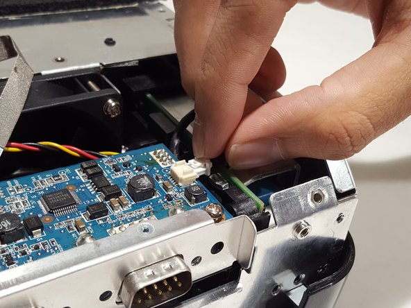

    • Remove cables from motherboard.
    • Unscrew motherboard and remove from device.

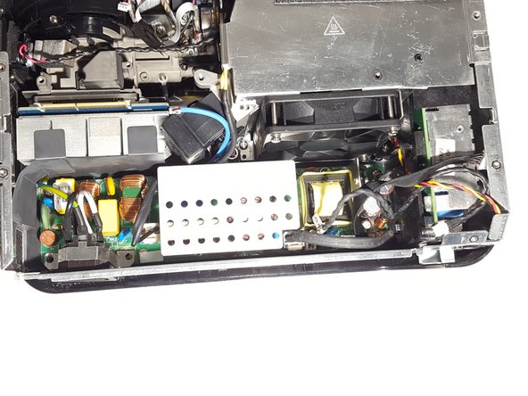

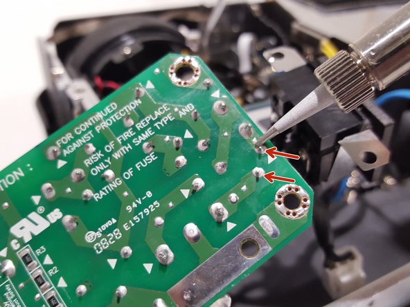

  11. Toshiba TDP-XP2 Fuse Replacement: crwdns2935265:011crwdnd2935265:01crwdnd2935265:02crwdne2935265:0 Toshiba TDP-XP2 Fuse Replacement: crwdns2935265:011crwdnd2935265:02crwdnd2935265:02crwdne2935265:0
    • Locate the fuse near where the power adapter was.
    • De-solder the fuse and replace with an equivalent fuse (Fuse leads to de-solder are marked in red).
