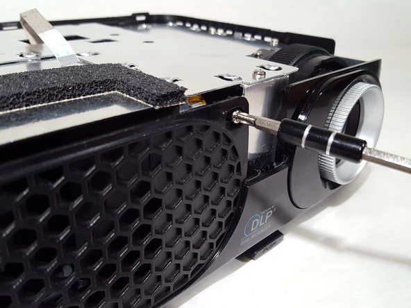

    • Start by removing the two screws on the bottom of the device as shown.

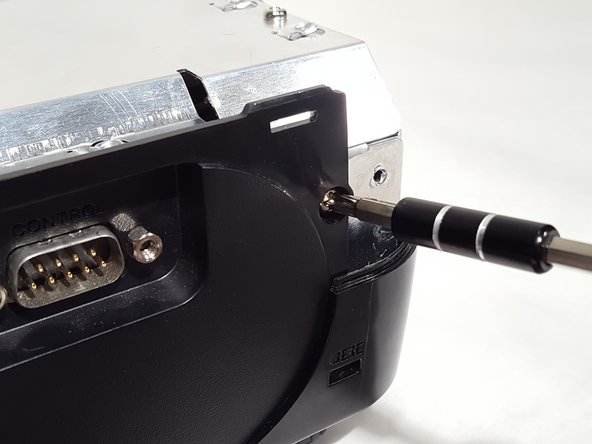

    • Remove the screws from the case located around the device.

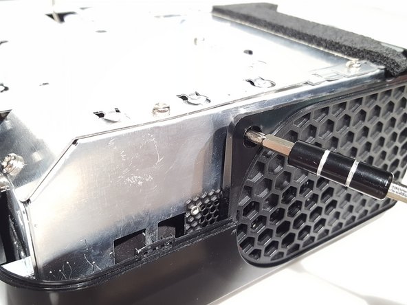

    • Remove the plastic panels from the body.

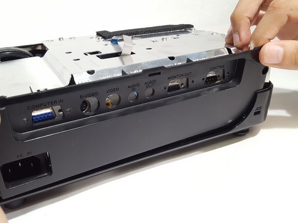

  5. Toshiba TDP-XP2 Fan Replacement: crwdns2935265:05crwdnd2935265:01crwdnd2935265:03crwdne2935265:0 Toshiba TDP-XP2 Fan Replacement: crwdns2935265:05crwdnd2935265:02crwdnd2935265:03crwdne2935265:0 Toshiba TDP-XP2 Fan Replacement: crwdns2935265:05crwdnd2935265:03crwdnd2935265:03crwdne2935265:0
    • Remove the screws from the IO panel.
    • Pull up on the panel and remove it.

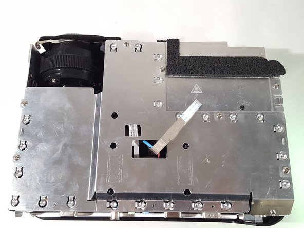

  6. Toshiba TDP-XP2 Fan Replacement: crwdns2935265:06crwdnd2935265:01crwdnd2935265:02crwdne2935265:0 Toshiba TDP-XP2 Fan Replacement: crwdns2935265:06crwdnd2935265:02crwdnd2935265:02crwdne2935265:0
    • Unscrew the screws from the metal shielding to remove it.

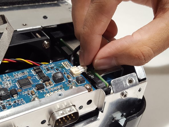

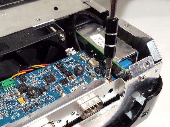

    • Remove cables from motherboard.
    • Unscrew motherboard and remove from device.
  8. Toshiba TDP-XP2 Fan Replacement: crwdns2935265:08crwdnd2935265:01crwdnd2935265:01crwdne2935265:0
    • Remove the cable from the bottom of the motherboard to fully remove it.

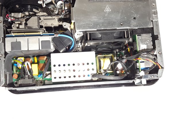

    • Unscrew the power adapter on the back.
  10. Toshiba TDP-XP2 Fan Replacement: crwdns2935265:010crwdnd2935265:01crwdnd2935265:02crwdne2935265:0 Toshiba TDP-XP2 Fan Replacement: crwdns2935265:010crwdnd2935265:02crwdnd2935265:02crwdne2935265:0
    • Remove cables from the power supply board.
    • Remove the screws located around the board to un-mount it.
  11. Toshiba TDP-XP2 Fan Replacement: crwdns2935265:011crwdnd2935265:01crwdnd2935265:01crwdne2935265:0
    • Remove the power board to reveal the bottom two screws to the fan.
    • Unscrew the fan and replace it with an equivalent one.
