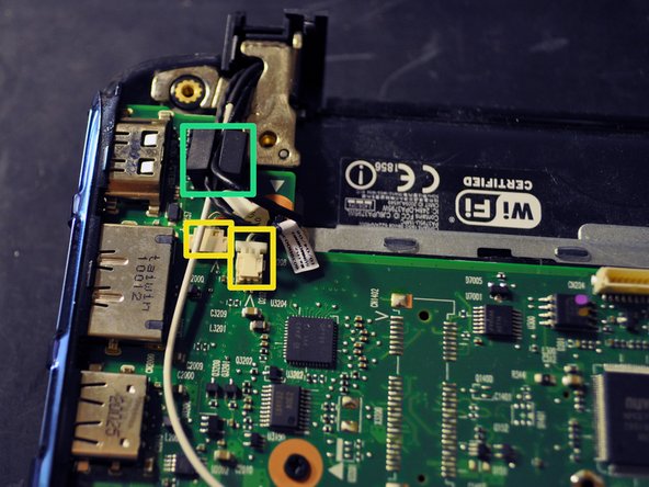

  16. Toshiba Satellite e205 Motherboard Replacement, Motherboard: crwdns2935265:016crwdnd2935265:01crwdnd2935265:01crwdne2935265:0
    • Carefully flip the laptop rightside up and open the lid.
    • Disconnect the cables from the motherboard.
  17. Toshiba Satellite e205 Motherboard Replacement: crwdns2935265:017crwdnd2935265:01crwdnd2935265:02crwdne2935265:0 Toshiba Satellite e205 Motherboard Replacement: crwdns2935265:017crwdnd2935265:02crwdnd2935265:02crwdne2935265:0
    • Close the laptop lid, and flip back over so you see the motherboard.
    • Disconnect all cables from the motherboard.

This guide could really use an explanation of how to disconnect the different types of cables from the motherboard. In particular, the descriptions for steps 16 and 17 are completely inadequate to me.
