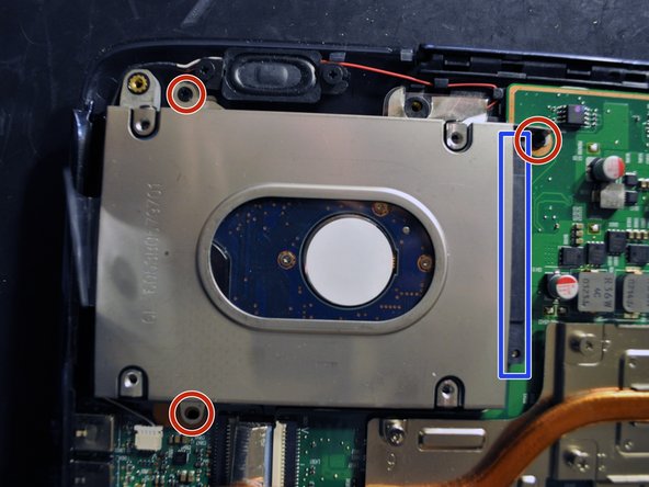

  13. Toshiba Satellite e205 Hard Drive Replacement, Hard Drive: crwdns2935265:013crwdnd2935265:01crwdnd2935265:02crwdne2935265:0 Toshiba Satellite e205 Hard Drive Replacement, Hard Drive: crwdns2935265:013crwdnd2935265:02crwdnd2935265:02crwdne2935265:0
    • Locate the hard drive.
    • Remove the three screws.
    • Slide the hard drive out away from the motherboard connector.
    • Once the hard drive is disconnected it lifts out.
