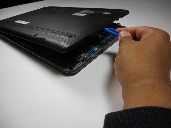

  3. Toshiba Satellite U925T-S2120 Heat Sink Replacement: crwdns2935265:03crwdnd2935265:01crwdnd2935265:02crwdne2935265:0 Toshiba Satellite U925T-S2120 Heat Sink Replacement: crwdns2935265:03crwdnd2935265:02crwdnd2935265:02crwdne2935265:0
    • Remove the back panel by inserting the plastic opening tool into the seam of the laptop and pushing the opening tool downwards.
