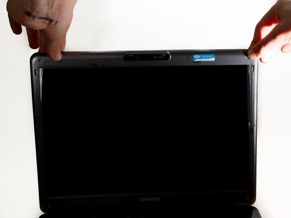

    • Use a plastic opening tool to separate the front plastic panel from the back side of the top of the laptop.
    • Carefully pull the top away from the back.

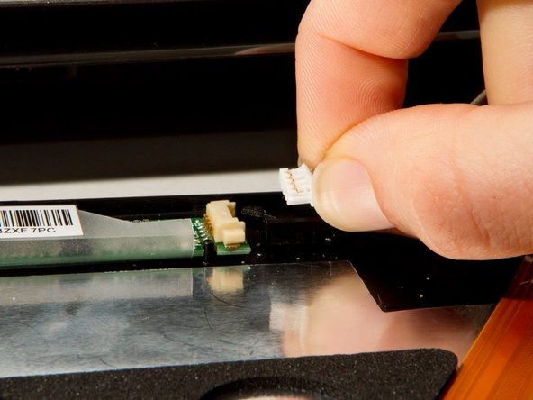

    • Turn the laptop around.
    • Remove the webcam/microphone data cable.
  5. Toshiba Satellite U405D-S2902 Display Replacement: crwdns2935265:05crwdnd2935265:01crwdnd2935265:02crwdne2935265:0 Toshiba Satellite U405D-S2902 Display Replacement: crwdns2935265:05crwdnd2935265:02crwdnd2935265:02crwdne2935265:0
    • Remove the lower lighting power supply.
    • Remove the signal light power supply and data cable.

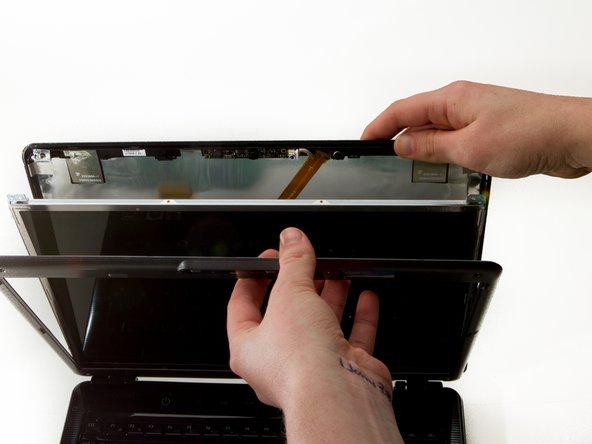

    • Locate and remove the four 2mm #1 Phillips screws around the sidewalls of the display.
    • After removing the last screw, the screen will be very loose, be sure to keep a hand on it to prevent it from damaging the keyboard.
  7. Toshiba Satellite U405D-S2902 Display Replacement: crwdns2935265:07crwdnd2935265:01crwdnd2935265:02crwdne2935265:0 Toshiba Satellite U405D-S2902 Display Replacement: crwdns2935265:07crwdnd2935265:02crwdnd2935265:02crwdne2935265:0
    • Carefully remove the screen from the side brackets.
    • Remove the LCD ribbon connector from the display.
