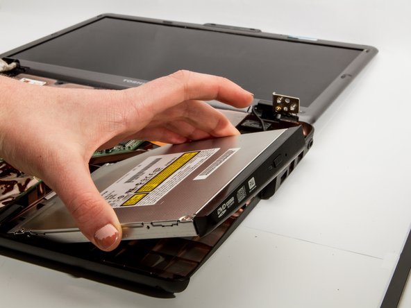

  9. Toshiba Satellite U405D-S2902 CD/DVD Drive Replacement: crwdns2935265:09crwdnd2935265:01crwdnd2935265:02crwdne2935265:0 Toshiba Satellite U405D-S2902 CD/DVD Drive Replacement: crwdns2935265:09crwdnd2935265:02crwdnd2935265:02crwdne2935265:0
    • Gently lift the disk drive by its outward facing edge (the one with writing on it).
    • Pull the disk drive up and away from the laptop.
