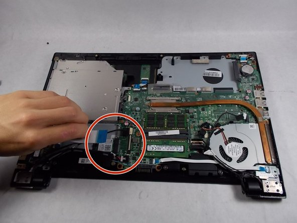

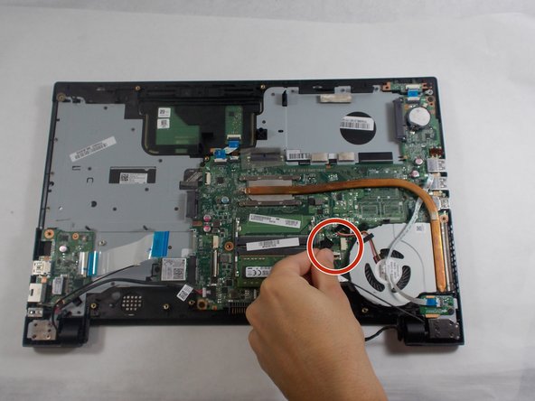

    • Disconnect LAN from the motherboard power wire. Pop up the white clamp that holds it in place, then pull the wire out.
  12. Toshiba Satellite S55t-C5225 Screen Assembly Replacement: crwdns2935265:012crwdnd2935265:01crwdnd2935265:02crwdne2935265:0 Toshiba Satellite S55t-C5225 Screen Assembly Replacement: crwdns2935265:012crwdnd2935265:02crwdnd2935265:02crwdne2935265:0

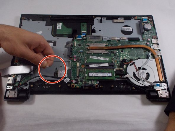

    • Disconnect the two cables connecting the screen assembly to the WIFI card.

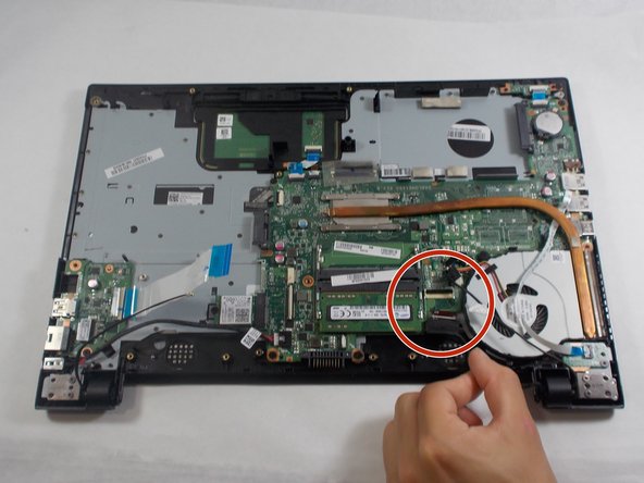

    • Disconnect all remaining cables that connect the screen assembly to the motherboard.
  14. Toshiba Satellite S55t-C5225 Screen Assembly Replacement: crwdns2935265:014crwdnd2935265:01crwdnd2935265:01crwdne2935265:0

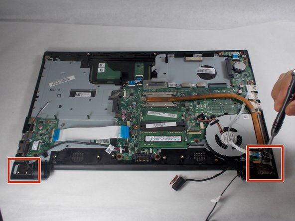

    • Remove the four 7.0 mm Phillips #0 screws on both ends of the laptop that attach the screen assembly to the laptop.

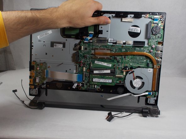

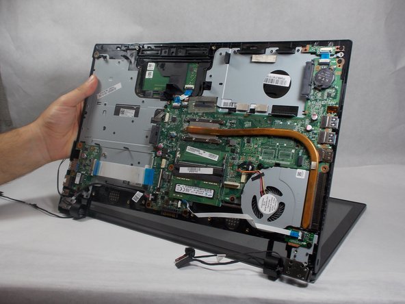

    • Slowly open laptop while the bottom is facing up. Begin to separate the bottom of laptop from the screen assembly brackets.
    • Remove the screen assembly.
