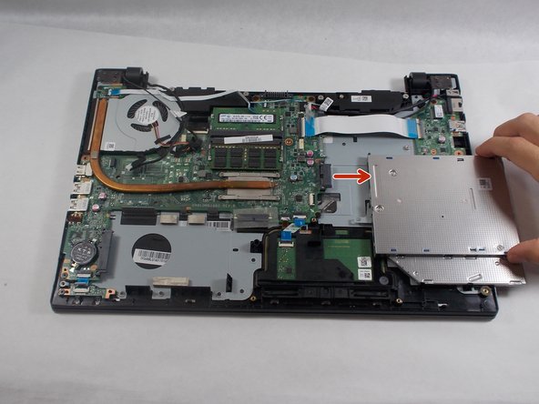

  7. Toshiba Satellite S55t-C5225 Optical Disk Drive Replacement, Optical Disk Drive: crwdns2935265:07crwdnd2935265:01crwdnd2935265:02crwdne2935265:0 Toshiba Satellite S55t-C5225 Optical Disk Drive Replacement, Optical Disk Drive: crwdns2935265:07crwdnd2935265:02crwdnd2935265:02crwdne2935265:0
    • Carefully slide the optical disk drive to the right to remove from the motherboard.
