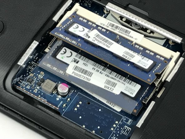

    • Unscrew the single Phillips #0 screw from the RAM panel.
  2. Toshiba Satellite S55t-A5389 RAM Replacement: crwdns2935265:02crwdnd2935265:01crwdnd2935265:01crwdne2935265:0
    • Remove the panel.
  3. Toshiba Satellite S55t-A5389 RAM Replacement: crwdns2935265:03crwdnd2935265:01crwdnd2935265:02crwdne2935265:0 Toshiba Satellite S55t-A5389 RAM Replacement: crwdns2935265:03crwdnd2935265:02crwdnd2935265:02crwdne2935265:0
    • Spread the clips away from the RAM module.
    • When released, the RAM module will pop up at a slight angle.

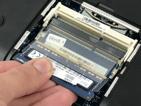

  4. Toshiba Satellite S55t-A5389 RAM Replacement: crwdns2935265:04crwdnd2935265:01crwdnd2935265:02crwdne2935265:0 Toshiba Satellite S55t-A5389 RAM Replacement: crwdns2935265:04crwdnd2935265:02crwdnd2935265:02crwdne2935265:0
    • Lift the RAM module to an angle of about 30 degrees and slide it out.
When installing the new RAM, push the RAM sticks in at an angle. Proceed to push each RAM stick down until the latches click, indicating that it is locked in.
