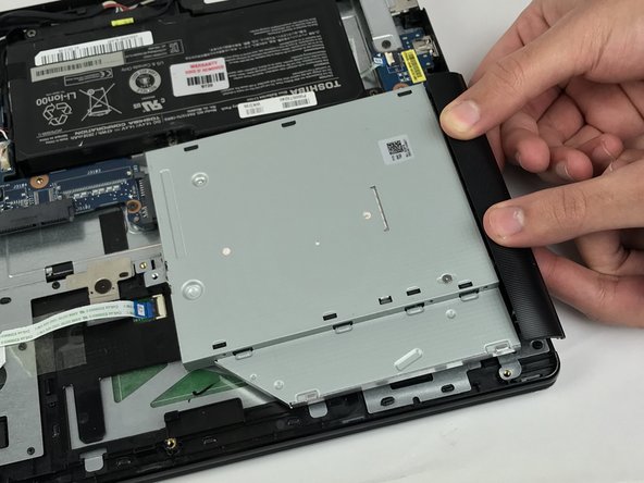

    • Remove the fourteen 5mm Phillips #0 screws from the bottom of the laptop.
  2. Toshiba Satellite S55t-A5389 Optical Drive Replacement: crwdns2935265:02crwdnd2935265:01crwdnd2935265:02crwdne2935265:0 Toshiba Satellite S55t-A5389 Optical Drive Replacement: crwdns2935265:02crwdnd2935265:02crwdnd2935265:02crwdne2935265:0
    • Using the plastic prying tools, go around the edge of the back of the laptop to release the back cover.
    • Pull the drive outwards to remove it.
