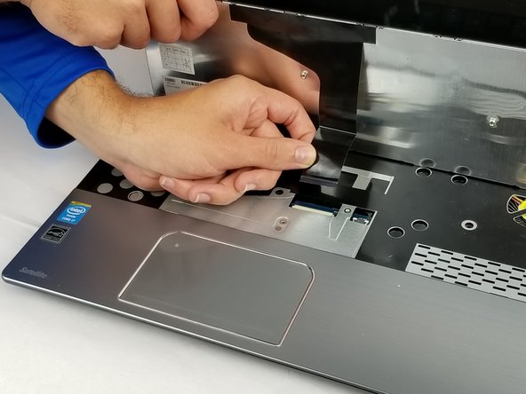

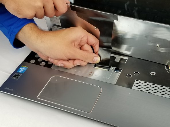

  3. Toshiba Satellite S55t-A5389 Keyboard Replacement: crwdns2935265:03crwdnd2935265:01crwdnd2935265:03crwdne2935265:0 Toshiba Satellite S55t-A5389 Keyboard Replacement: crwdns2935265:03crwdnd2935265:02crwdnd2935265:03crwdne2935265:0 Toshiba Satellite S55t-A5389 Keyboard Replacement: crwdns2935265:03crwdnd2935265:03crwdnd2935265:03crwdne2935265:0
    • Lift the keyboard up, but not all the way since there's a ribbon cable attached underneath.
    • Underneath the keyboard is a ribbon cable that attaches it to the rest of the laptop.
    • Unlock the ribbon cable by lifting up the two small locks on both sides of the connector on the motherboard.
    • Once unlocked, remove the ribbon cable and keyboard from the laptop.
