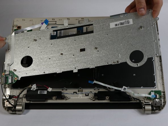

  16. Toshiba Satellite S55T-B5335 Keyboard Replacement, Keyboard: crwdns2935265:016crwdnd2935265:01crwdnd2935265:01crwdne2935265:0
    • Remove the twenty-seven 2 mm Phillips #0 screws that secure the keyboard retaining plate.
  17. Toshiba Satellite S55T-B5335 Keyboard Replacement: crwdns2935265:017crwdnd2935265:01crwdnd2935265:02crwdne2935265:0 Toshiba Satellite S55T-B5335 Keyboard Replacement: crwdns2935265:017crwdnd2935265:02crwdnd2935265:02crwdne2935265:0
    • Carefully lift the keyboard retaining plate away from the laptop making sure not to damage any connectors.

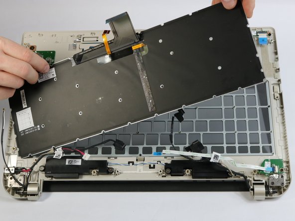

  18. Toshiba Satellite S55T-B5335 Keyboard Replacement: crwdns2935265:018crwdnd2935265:01crwdnd2935265:02crwdne2935265:0 Toshiba Satellite S55T-B5335 Keyboard Replacement: crwdns2935265:018crwdnd2935265:02crwdnd2935265:02crwdne2935265:0
    • Lift up on the keyboard to remove it from the laptop.
