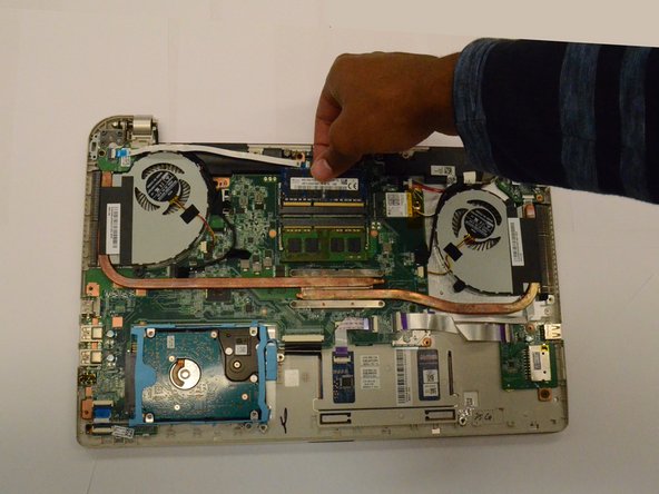

  3. Toshiba Satellite S50-B RAM Replacement, RAM: crwdns2935265:03crwdnd2935265:01crwdnd2935265:03crwdne2935265:0 Toshiba Satellite S50-B RAM Replacement, RAM: crwdns2935265:03crwdnd2935265:02crwdnd2935265:03crwdne2935265:0 Toshiba Satellite S50-B RAM Replacement, RAM: crwdns2935265:03crwdnd2935265:03crwdnd2935265:03crwdne2935265:0
    • Unscrew all 6.5mm screws on the bottom of the laptop using a Phillips #0 Screwdriver
    • Using the plastic opening tools, open the back cover and remove it from the laptop.
  4. Toshiba Satellite S50-B RAM Replacement: crwdns2935265:04crwdnd2935265:01crwdnd2935265:02crwdne2935265:0 Toshiba Satellite S50-B RAM Replacement: crwdns2935265:04crwdnd2935265:02crwdnd2935265:02crwdne2935265:0
    • Push down on the clips on either side of the RAM stick evenly.
    • Pull out the RAM stick. Make sure the notches on the RAM stick align with the notches in the RAM holder.
