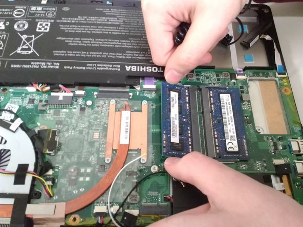

  5. Toshiba Satellite Radius P55W-B5220 RAM Replacement, RAM: crwdns2935265:05crwdnd2935265:01crwdnd2935265:02crwdne2935265:0 Toshiba Satellite Radius P55W-B5220 RAM Replacement, RAM: crwdns2935265:05crwdnd2935265:02crwdnd2935265:02crwdne2935265:0
    • Push outward on the clamps holding the RAM in place.
  6. Toshiba Satellite Radius P55W-B5220 RAM Replacement: crwdns2935265:06crwdnd2935265:01crwdnd2935265:01crwdne2935265:0
    • Remove the RAM chips.
