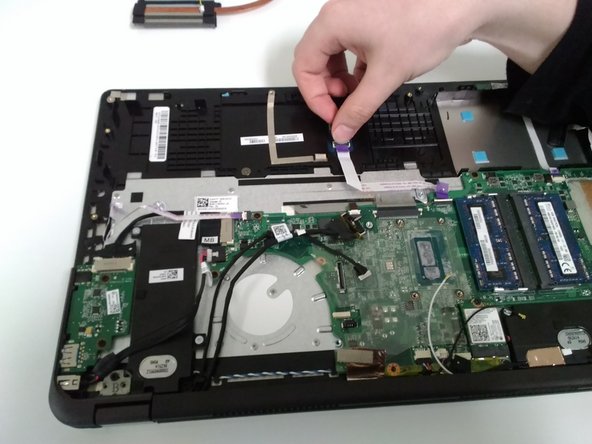

  7. Toshiba Satellite Radius P55W-B5220 Motherboard Replacement: crwdns2935265:07crwdnd2935265:01crwdnd2935265:03crwdne2935265:0 Toshiba Satellite Radius P55W-B5220 Motherboard Replacement: crwdns2935265:07crwdnd2935265:02crwdnd2935265:03crwdne2935265:0 Toshiba Satellite Radius P55W-B5220 Motherboard Replacement: crwdns2935265:07crwdnd2935265:03crwdnd2935265:03crwdne2935265:0
    • Disconnect the ribbon cable of the touchpad from the motherboard.

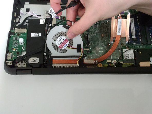

    • Remove the two M2x2.5mm P0 Philips screws from the fan.
  9. Toshiba Satellite Radius P55W-B5220 Motherboard Replacement: crwdns2935265:09crwdnd2935265:01crwdnd2935265:03crwdne2935265:0 Toshiba Satellite Radius P55W-B5220 Motherboard Replacement: crwdns2935265:09crwdnd2935265:02crwdnd2935265:03crwdne2935265:0 Toshiba Satellite Radius P55W-B5220 Motherboard Replacement: crwdns2935265:09crwdnd2935265:03crwdnd2935265:03crwdne2935265:0
    • Disconnect the fan cables.
    • Carefully unhook the wires from the base of the fan.

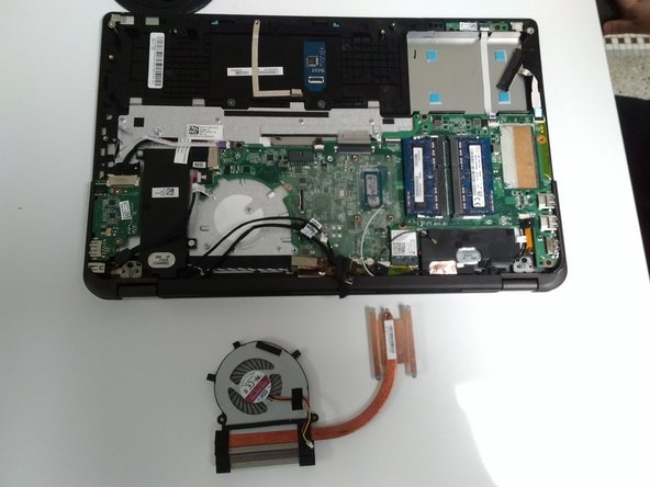

    • Unscrew the four M2x4mm PH0 Philips screws from the CPU mounts on the motherboard.
  11. Toshiba Satellite Radius P55W-B5220 Motherboard Replacement: crwdns2935265:011crwdnd2935265:01crwdnd2935265:03crwdne2935265:0 Toshiba Satellite Radius P55W-B5220 Motherboard Replacement: crwdns2935265:011crwdnd2935265:02crwdnd2935265:03crwdne2935265:0 Toshiba Satellite Radius P55W-B5220 Motherboard Replacement: crwdns2935265:011crwdnd2935265:03crwdnd2935265:03crwdne2935265:0
    • Carefully lift the heatsink off the CPU.
    • Avoid bending or kinking the tubing.
    • Delicately lift the fan out with the heatsink.
