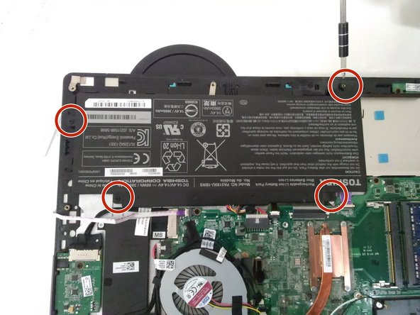

  5. Toshiba Satellite Radius P55W-B5220 Battery Replacement, Battery: crwdns2935265:05crwdnd2935265:01crwdnd2935265:02crwdne2935265:0 Toshiba Satellite Radius P55W-B5220 Battery Replacement, Battery: crwdns2935265:05crwdnd2935265:02crwdnd2935265:02crwdne2935265:0
    • Remove the four M2x2.5mm P0 Philips head screws.
  6. Toshiba Satellite Radius P55W-B5220 Battery Replacement: crwdns2935265:06crwdnd2935265:01crwdnd2935265:02crwdne2935265:0 Toshiba Satellite Radius P55W-B5220 Battery Replacement: crwdns2935265:06crwdnd2935265:02crwdnd2935265:02crwdne2935265:0
    • Pinch the attached cables and carefully pull away to remove the battery.
