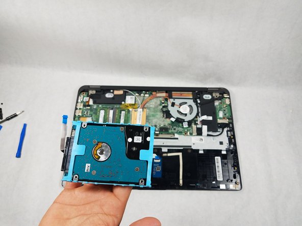

  7. Toshiba Satellite Radius P55W-B5112 Hard Drive Replacement Replacement, Hard Drive Replacement: crwdns2935265:07crwdnd2935265:01crwdnd2935265:02crwdne2935265:0 Toshiba Satellite Radius P55W-B5112 Hard Drive Replacement Replacement, Hard Drive Replacement: crwdns2935265:07crwdnd2935265:02crwdnd2935265:02crwdne2935265:0
    • Use a plastic opening tool to detach the hard drive's ribbon cable from the computer. Gently lift the black lever at cable's point of attachment to the computer to release it.
  8. Toshiba Satellite Radius P55W-B5112 Hard Drive Replacement Replacement: crwdns2935265:08crwdnd2935265:01crwdnd2935265:02crwdne2935265:0 Toshiba Satellite Radius P55W-B5112 Hard Drive Replacement Replacement: crwdns2935265:08crwdnd2935265:02crwdnd2935265:02crwdne2935265:0
    • Lift the hard drive from the computer, starting with the edge adjacent to the empty battery slot
    • There may be some resistence as you remove the hard drive. Wiggling it up and down as you pull it away from the computer will help combat this.
