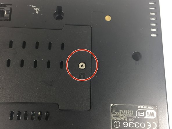

    • Locate the cover where the RAM is located.
    • Locate the screw.
  4. Toshiba Satellite R15-S829 RAM Replacement: crwdns2935265:04crwdnd2935265:01crwdnd2935265:02crwdne2935265:0 Toshiba Satellite R15-S829 RAM Replacement: crwdns2935265:04crwdnd2935265:02crwdnd2935265:02crwdne2935265:0
    • Loosen the screw for the cover. The screw is attached to the cover, so you don't need to worry about losing it.
    • Lift the cover.
