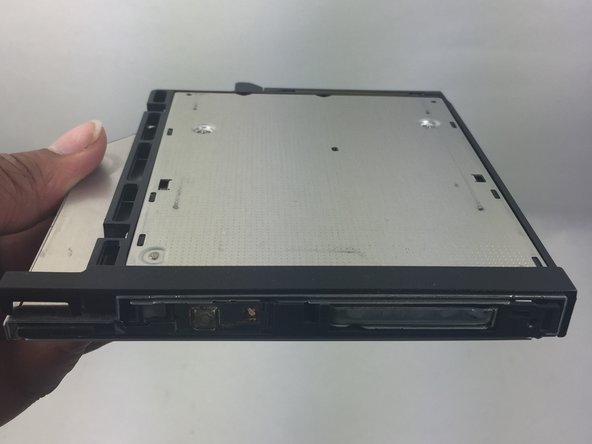

    • Locate the disk drive on the side of the laptop.
  4. Toshiba Satellite R15-S829 Disk Drive Replacement: crwdns2935265:04crwdnd2935265:01crwdnd2935265:01crwdne2935265:0
    • Locate the indent on disk drive on the backside of the computer.
  5. Toshiba Satellite R15-S829 Disk Drive Replacement: crwdns2935265:05crwdnd2935265:01crwdnd2935265:02crwdne2935265:0 Toshiba Satellite R15-S829 Disk Drive Replacement: crwdns2935265:05crwdnd2935265:02crwdnd2935265:02crwdne2935265:0
    • Use your hand to remove the disk drive by pulling outward.
  6. Toshiba Satellite R15-S829 Disk Drive Replacement: crwdns2935265:06crwdnd2935265:01crwdnd2935265:03crwdne2935265:0 Toshiba Satellite R15-S829 Disk Drive Replacement: crwdns2935265:06crwdnd2935265:02crwdnd2935265:03crwdne2935265:0 Toshiba Satellite R15-S829 Disk Drive Replacement: crwdns2935265:06crwdnd2935265:03crwdnd2935265:03crwdne2935265:0
    • Push the end of a paperclip into the small hole on the disk drive to open it if there is a disk that is stuck in the drive.
