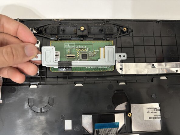

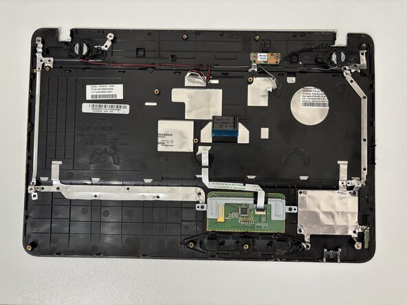

  4. Toshiba Satellite PSC0YC-007026 Touchpad Replacement: crwdns2935265:04crwdnd2935265:01crwdnd2935265:03crwdne2935265:0 Toshiba Satellite PSC0YC-007026 Touchpad Replacement: crwdns2935265:04crwdnd2935265:02crwdnd2935265:03crwdne2935265:0 Toshiba Satellite PSC0YC-007026 Touchpad Replacement: crwdns2935265:04crwdnd2935265:03crwdnd2935265:03crwdne2935265:0
    • Use a spudger or a clean fingernail to flip up the locking flap on the touchpad connector.
    • Use tweezers to remove the ribbon cable from the socket on the touchpad board.
  5. Toshiba Satellite PSC0YC-007026 Touchpad Replacement: crwdns2935265:05crwdnd2935265:01crwdnd2935265:02crwdne2935265:0 Toshiba Satellite PSC0YC-007026 Touchpad Replacement: crwdns2935265:05crwdnd2935265:02crwdnd2935265:02crwdne2935265:0
    • Use a JIS #0 to remove the two screws from the bracket covering the touchpad.
    • Remove the bracket.
  6. Toshiba Satellite PSC0YC-007026 Touchpad Replacement: crwdns2935265:06crwdnd2935265:01crwdnd2935265:01crwdne2935265:0
    • Gently push up on the touchpad from below to remove it.
    • If the touchpad is glued on heavily, use a hot air blower to soften the adhesive first.
