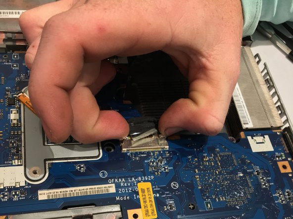

  6. Toshiba Satellite P855-S5312 Hinge  Replacement, Screen: crwdns2935265:06crwdnd2935265:01crwdnd2935265:03crwdne2935265:0 Toshiba Satellite P855-S5312 Hinge  Replacement, Screen: crwdns2935265:06crwdnd2935265:02crwdnd2935265:03crwdne2935265:0 Toshiba Satellite P855-S5312 Hinge  Replacement, Screen: crwdns2935265:06crwdnd2935265:03crwdnd2935265:03crwdne2935265:0
    • Turn laptop upside down with the spine facing towards you and locate the microchip.
    • Remove the white and black sliding connector wires by prying upward with tweezers gently pulling the black and white wires upwards.
  7. Toshiba Satellite P855-S5312 Hinge  Replacement: crwdns2935265:07crwdnd2935265:01crwdnd2935265:02crwdne2935265:0 Toshiba Satellite P855-S5312 Hinge  Replacement: crwdns2935265:07crwdnd2935265:02crwdnd2935265:02crwdne2935265:0
    • Unplug the single ZIF connector ribbon by gently pulling up.
    • Pull the white and black wires through from the underside of device.

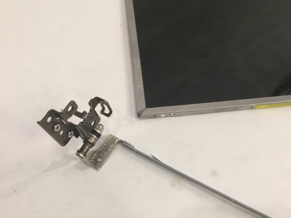

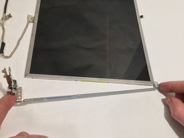

  16. Toshiba Satellite P855-S5312 Hinge  Replacement, Hinge: crwdns2935265:016crwdnd2935265:01crwdnd2935265:03crwdne2935265:0 Toshiba Satellite P855-S5312 Hinge  Replacement, Hinge: crwdns2935265:016crwdnd2935265:02crwdnd2935265:03crwdne2935265:0 Toshiba Satellite P855-S5312 Hinge  Replacement, Hinge: crwdns2935265:016crwdnd2935265:03crwdnd2935265:03crwdne2935265:0
    • Remove the three screws on the sides of the screen using the Philips #0 screwdriver.
    • Once unscrewed, pull the frame off along with the hinge.
