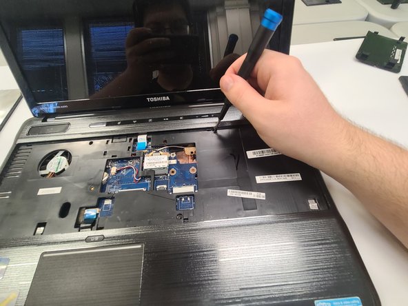

    • Flip the device over and open it up.
    • Using your pry tool begin to pop the keyboard upwards starting from the side closest to the screen. You will hear an audible "pop" sound.
  8. Toshiba Satellite P755-EZ1511D Laptop Speakers Replacement: crwdns2935265:08crwdnd2935265:01crwdnd2935265:03crwdne2935265:0 Toshiba Satellite P755-EZ1511D Laptop Speakers Replacement: crwdns2935265:08crwdnd2935265:02crwdnd2935265:03crwdne2935265:0 Toshiba Satellite P755-EZ1511D Laptop Speakers Replacement: crwdns2935265:08crwdnd2935265:03crwdnd2935265:03crwdne2935265:0
    • After popping the keyboard off you need to disconnect the keyboard from the motherboard.
