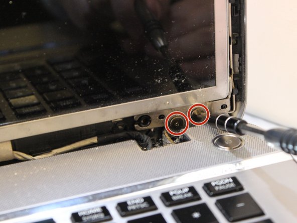

    • Open the laptop and unscrew each of the screws that are in the corners of the screen using a Phillips #1 screwdriver.

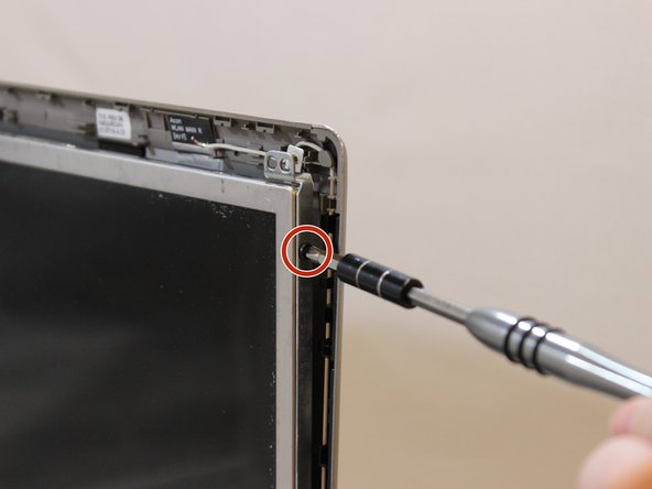

    • Using a Phillips #1 screwdriver, unscrew all of the screws on the sides of the screen.
