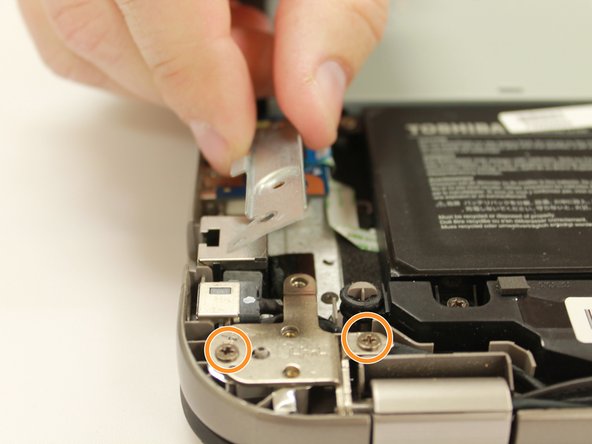

  6. Toshiba Satellite P55t-A5116 Power Jack Replacement, Power Jack: crwdns2935265:06crwdnd2935265:01crwdnd2935265:03crwdne2935265:0 Toshiba Satellite P55t-A5116 Power Jack Replacement, Power Jack: crwdns2935265:06crwdnd2935265:02crwdnd2935265:03crwdne2935265:0 Toshiba Satellite P55t-A5116 Power Jack Replacement, Power Jack: crwdns2935265:06crwdnd2935265:03crwdnd2935265:03crwdne2935265:0
    • Using the #PH0 screw head, remove 2 (5.7 mm) screws.
    • Remove metal plate.
    • Using the #PH0 screw head remove 1 (5.7mm) screw and 1 (4.15mm) screw.

Absolutely terrific tutorial! This helped me immensely. My laptop is Toshiba Satellite P55T-5202 and has the same layout as this. This worked perfectly.
I purchased the part form Amazon, btw. Its a DC Power Jack Replacement
