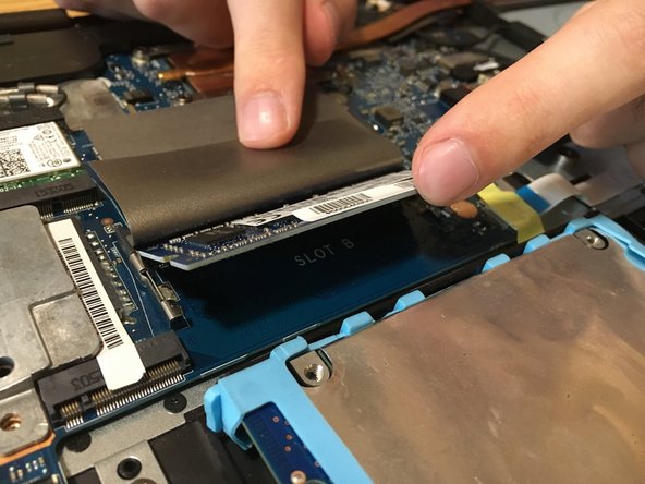

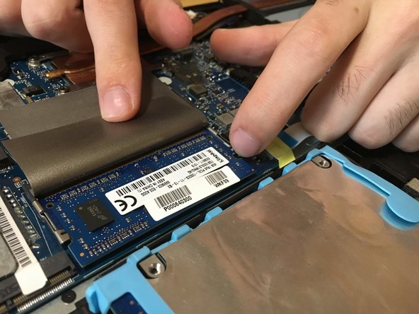

  5. Toshiba Satellite P55W-C5316 RAM Replacement, RAM: crwdns2935265:05crwdnd2935265:01crwdnd2935265:03crwdne2935265:0 Toshiba Satellite P55W-C5316 RAM Replacement, RAM: crwdns2935265:05crwdnd2935265:02crwdnd2935265:03crwdne2935265:0 Toshiba Satellite P55W-C5316 RAM Replacement, RAM: crwdns2935265:05crwdnd2935265:03crwdnd2935265:03crwdne2935265:0
    • Lift up the flap to expose the RAM chip.
    • Un-clip the RAM by pulling the metal clips away from the chip on both sides.
    • Lift the RAM up from the laptop and pull it away from the connector.
