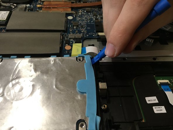

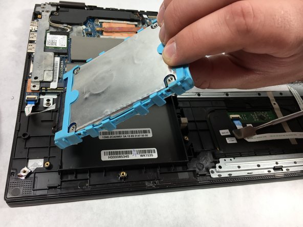

  5. Toshiba Satellite P55W-C5316 Hard Drive Replacement, Hard Drive: crwdns2935265:05crwdnd2935265:01crwdnd2935265:03crwdne2935265:0 Toshiba Satellite P55W-C5316 Hard Drive Replacement, Hard Drive: crwdns2935265:05crwdnd2935265:02crwdnd2935265:03crwdne2935265:0 Toshiba Satellite P55W-C5316 Hard Drive Replacement, Hard Drive: crwdns2935265:05crwdnd2935265:03crwdnd2935265:03crwdne2935265:0
    • Insert the opening tool between the hard drive and the laptop on the right hand side.
    • Gently lift the hard drive from the laptop.

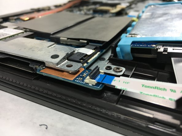

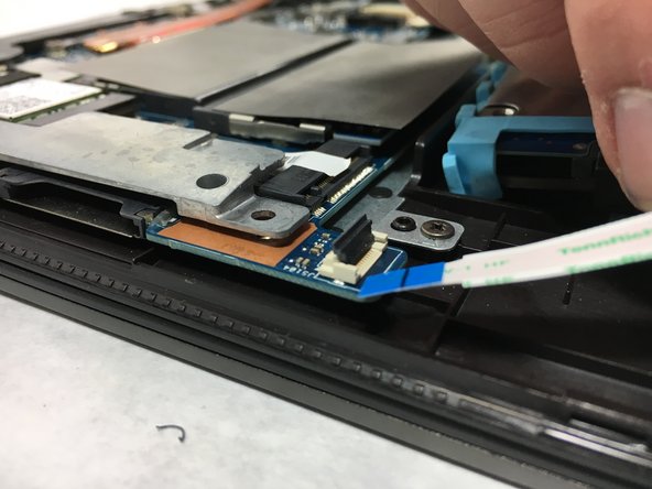

  6. Toshiba Satellite P55W-C5316 Hard Drive Replacement: crwdns2935265:06crwdnd2935265:01crwdnd2935265:03crwdne2935265:0 Toshiba Satellite P55W-C5316 Hard Drive Replacement: crwdns2935265:06crwdnd2935265:02crwdnd2935265:03crwdne2935265:0 Toshiba Satellite P55W-C5316 Hard Drive Replacement: crwdns2935265:06crwdnd2935265:03crwdnd2935265:03crwdne2935265:0
    • Do not pull on the ZIF connector that connects the hard drive to the laptop.
    • Lift the black clip on the end of the ZIF connector.
    • Gently remove the cable from the connector.
