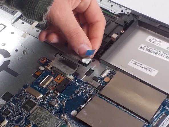

  10. Toshiba Satellite P55W-C5200X Keyboard Replacement, Keyboard: crwdns2935265:010crwdnd2935265:01crwdnd2935265:01crwdne2935265:0
    • Once the fan, ram, and battery are removed, remove the motherboard.
    • Detach the three connecting wires.
    • Remove the white, blue-tipped cable ribbon too.

  12. Toshiba Satellite P55W-C5200X Keyboard Replacement: crwdns2935265:012crwdnd2935265:01crwdnd2935265:02crwdne2935265:0 Toshiba Satellite P55W-C5200X Keyboard Replacement: crwdns2935265:012crwdnd2935265:02crwdnd2935265:02crwdne2935265:0
    • Remove the ribbon by using the black nylon spudger to avoid tearing the ribbon.

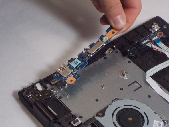

  17. Toshiba Satellite P55W-C5200X Keyboard Replacement: crwdns2935265:017crwdnd2935265:01crwdnd2935265:02crwdne2935265:0 Toshiba Satellite P55W-C5200X Keyboard Replacement: crwdns2935265:017crwdnd2935265:02crwdnd2935265:02crwdne2935265:0
    • Once the connecting wires are removed, remove the 8.0 mm screw of the USB ports, using the Phillips #00 screwdriver.
    • Gently remove the USB ports.
