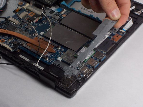

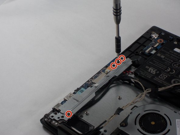

    • Use the Phillips #00 screwdriver to remove the six 5.0 mm screws that are holding the metal brackets on both sides in place.
    • Gently remove both metal brackets.

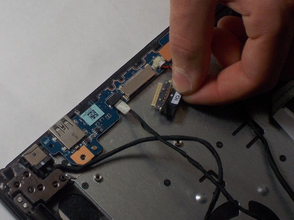

    • Remove he three wires connected to the motherboard.
  8. Toshiba Satellite P55W-C5200X Display Replacement: crwdns2935265:08crwdnd2935265:01crwdnd2935265:03crwdne2935265:0 Toshiba Satellite P55W-C5200X Display Replacement: crwdns2935265:08crwdnd2935265:02crwdnd2935265:03crwdne2935265:0 Toshiba Satellite P55W-C5200X Display Replacement: crwdns2935265:08crwdnd2935265:03crwdnd2935265:03crwdne2935265:0

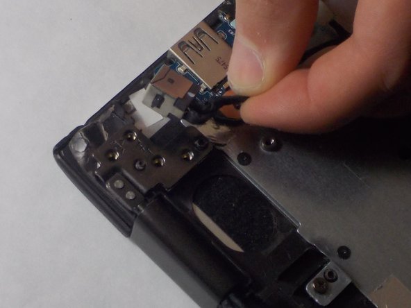

    • On the other side remove the four remaining wires from their ports.
  9. Toshiba Satellite P55W-C5200X Display Replacement: crwdns2935265:09crwdnd2935265:01crwdnd2935265:03crwdne2935265:0 Toshiba Satellite P55W-C5200X Display Replacement: crwdns2935265:09crwdnd2935265:02crwdnd2935265:03crwdne2935265:0 Toshiba Satellite P55W-C5200X Display Replacement: crwdns2935265:09crwdnd2935265:03crwdnd2935265:03crwdne2935265:0
    • Lift two sets of metal brackets up, one in each corner.
    • Depending on the force needed on your specific device, you may need to use the spudger.
