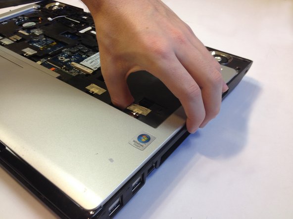

  31. Toshiba Satellite P205-S8811 Speakers Replacement: crwdns2935265:031crwdnd2935265:01crwdnd2935265:02crwdne2935265:0 Toshiba Satellite P205-S8811 Speakers Replacement: crwdns2935265:031crwdnd2935265:02crwdnd2935265:02crwdne2935265:0
    • Be careful not to pull too hard or too quickly on the laptop panels in these next parts as you may end up snapping the plastic or breaking some of the connected wires beneath.
    • Insert your thumb into the hole at the bottom right of the keyboard area and lift gently to loosen the top panel from the bottom of the laptop.
  32. Toshiba Satellite P205-S8811 Speakers Replacement: crwdns2935265:032crwdnd2935265:01crwdnd2935265:02crwdne2935265:0 Toshiba Satellite P205-S8811 Speakers Replacement: crwdns2935265:032crwdnd2935265:02crwdnd2935265:02crwdne2935265:0
    • Once you have lifted the panel up enough on the right side, you can insert your fingers or a spudger between the top and bottom panels.
    • Then gently move your fingers or spudger along the bottom and sides of the laptop, loosening the panel even more until it comes completely loose.
    • Once the top panel is completely loose lift the top panel up slightly so that the mousepad wire is visible underneath it. Unplug the mousepad wire from the bottom of the laptop.
