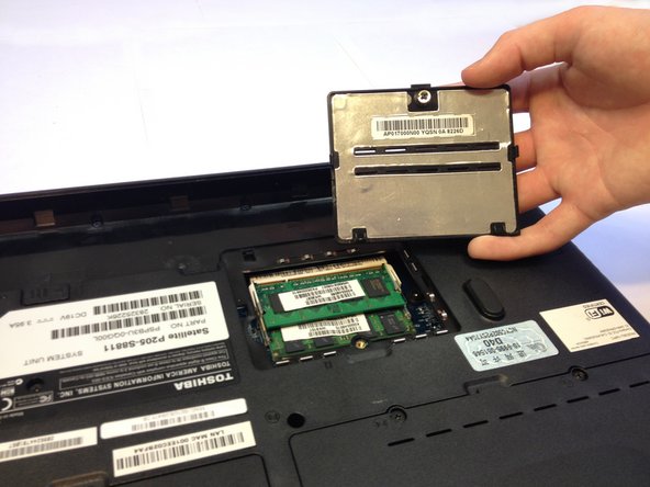

    • Locate the RAM slot cover on the bottom of the laptop. The RAM slot cover is located near the battery slot.
  4. Toshiba Satellite P205-S8811 RAM Replacement: crwdns2935265:04crwdnd2935265:01crwdnd2935265:01crwdne2935265:0
    • Using a Phillips-head screwdriver, unscrew and remove the screw holding the RAM slot cover in place.
  5. Toshiba Satellite P205-S8811 RAM Replacement: crwdns2935265:05crwdnd2935265:01crwdnd2935265:02crwdne2935265:0 Toshiba Satellite P205-S8811 RAM Replacement: crwdns2935265:05crwdnd2935265:02crwdnd2935265:02crwdne2935265:0
    • Lift and remove the RAM slot cover.
  6. Toshiba Satellite P205-S8811 RAM Replacement: crwdns2935265:06crwdnd2935265:01crwdnd2935265:02crwdne2935265:0 Toshiba Satellite P205-S8811 RAM Replacement: crwdns2935265:06crwdnd2935265:02crwdnd2935265:02crwdne2935265:0

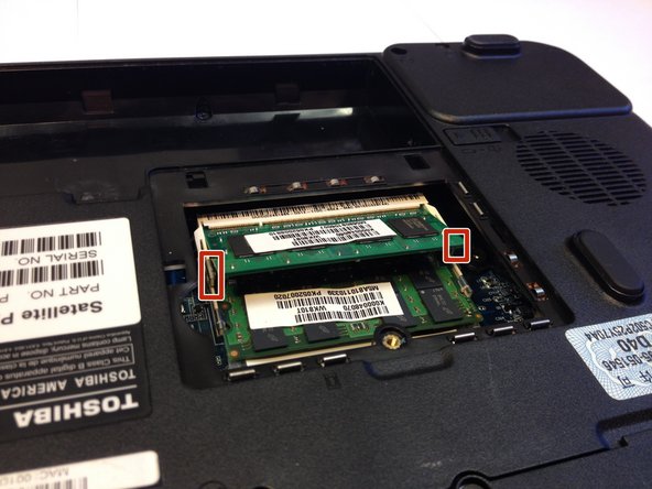

    • To remove the first RAM chip, gently press outward on the tabs on both sides of the chip
    • The RAM chip should pop up after releasing the tabs.
  7. Toshiba Satellite P205-S8811 RAM Replacement: crwdns2935265:07crwdnd2935265:01crwdnd2935265:01crwdne2935265:0
    • Using your fingers, remove the RAM chip by gently pulling it out of the RAM slot.
  8. Toshiba Satellite P205-S8811 RAM Replacement: crwdns2935265:08crwdnd2935265:01crwdnd2935265:02crwdne2935265:0 Toshiba Satellite P205-S8811 RAM Replacement: crwdns2935265:08crwdnd2935265:02crwdnd2935265:02crwdne2935265:0
    • To remove the second RAM chip, repeat the previous steps
