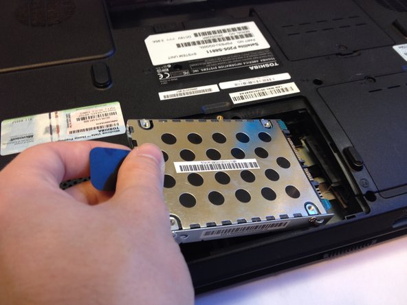

  3. Toshiba Satellite P205-S8811 Hard Drive Replacement, Hard Drive: crwdns2935265:03crwdnd2935265:01crwdnd2935265:01crwdne2935265:0
    • Use a #1 Phillips screwdriver to take out the 8mm Phillips #1 screw holding the hard drive panel on.
  4. Toshiba Satellite P205-S8811 Hard Drive Replacement: crwdns2935265:04crwdnd2935265:01crwdnd2935265:01crwdne2935265:0
    • Place one finger under the tab of the hard drive panel and lift up with medium force.
  5. Toshiba Satellite P205-S8811 Hard Drive Replacement: crwdns2935265:05crwdnd2935265:01crwdnd2935265:02crwdne2935265:0 Toshiba Satellite P205-S8811 Hard Drive Replacement: crwdns2935265:05crwdnd2935265:02crwdnd2935265:02crwdne2935265:0
    • Hold the black tab attached to the hard drive and pull with medium force to the side that the tab is on. This will pull the hard drive out of it's socket.
  6. Toshiba Satellite P205-S8811 Hard Drive Replacement: crwdns2935265:06crwdnd2935265:01crwdnd2935265:02crwdne2935265:0 Toshiba Satellite P205-S8811 Hard Drive Replacement: crwdns2935265:06crwdnd2935265:02crwdnd2935265:02crwdne2935265:0
    • Use a #1 Phillips screwdriver to unscrew the four 4mm Phillips #1 screws (2 on each side) holding the brackets to the hard drive.
    • With the screws undone, the brackets should come right off. Next, pull on the black tab again to pull the cover off of the hard drive.

There is a missing step between 4 and 5.
- Remove the screw(s) that hold the HDD assembly in its compartment.
...only then can you move on to step 5.
