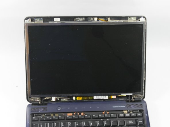

  4. Toshiba Satellite M305D-S4829 Screen Replacement: crwdns2935265:04crwdnd2935265:01crwdnd2935265:02crwdne2935265:0 Toshiba Satellite M305D-S4829 Screen Replacement: crwdns2935265:04crwdnd2935265:02crwdnd2935265:02crwdne2935265:0
    • Now you need to remove the bezel. This is the plastic frame around the screen. Gently pull it forward, and then upward to unsnap it from where it is connected at the hinges.
    • The second picture shows what the laptop will look like thus far.

    • Turn the laptop so the screen faces you again. Remove this screw, and the corresponding screw on the left hand side.
    • Remove the four screws on the sides of the metal frame, located at the upper right and left, as well as the lower right and left.
    • The screen may now be removed, and the replacement screen may be installed.
